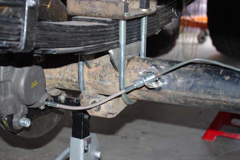

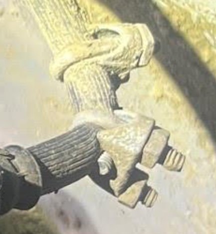

    And it looks like they clamped a small bolt in that first one, for whatever reason:
  12. Feb 19, 2025 at 3:25 PM
    #172
    Pappy Jon
    Pappy Jon Well-Known Member
    Aug 7, 2018
    #262063
    117
    RZN60LV
    3RZ
    Because it was leaking and they needed to stop the flow. Creative solution to a problem.

    Here is a pic from the EPC for my 1985 4Runner. This same set up was used at least through 1995 on mini-trucks. 47313A is the hose. 47344 is the hard line to caliper. I would not be surprised if this same general idea was used on the rear calipers on the Gen4 Tacoma.
    I've also seen hose connected direct to calipers using a banjo bolt. In fact, that is the way my
    GM calipers are set up on my rear disk brake conversion on my FJ40 (pic).
