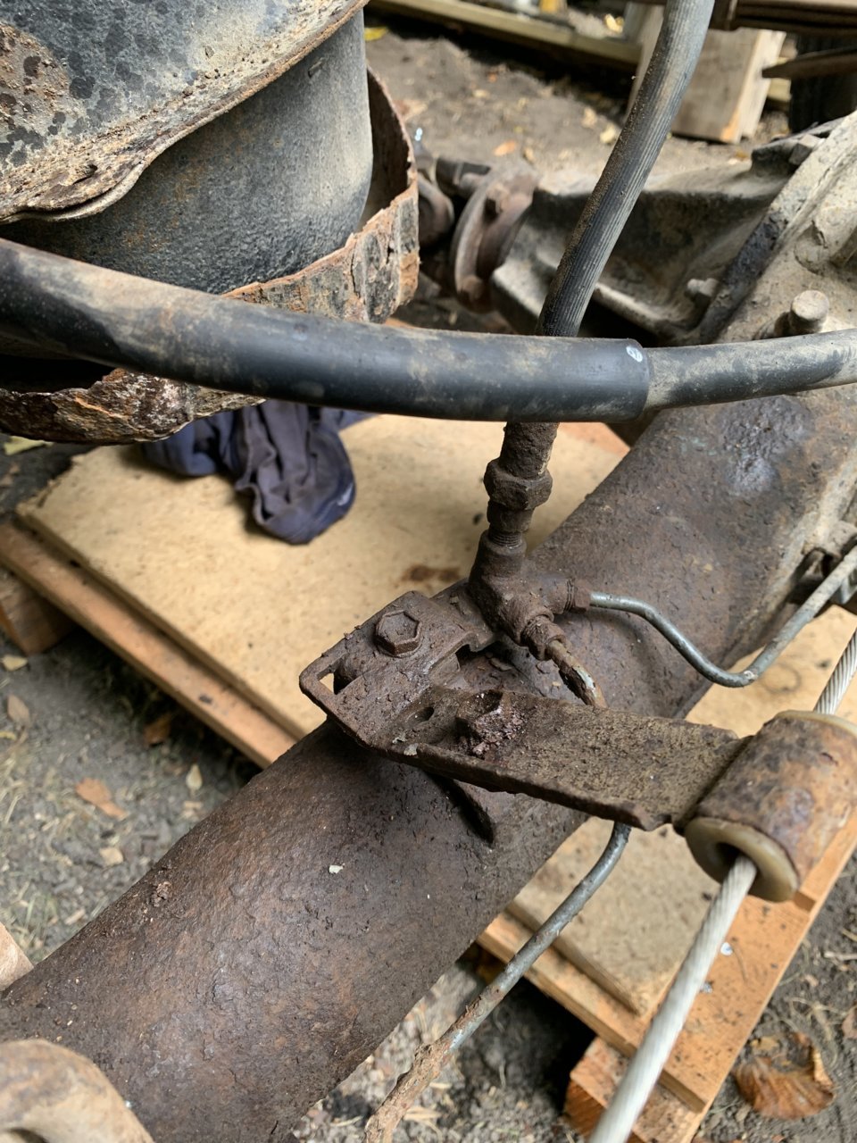

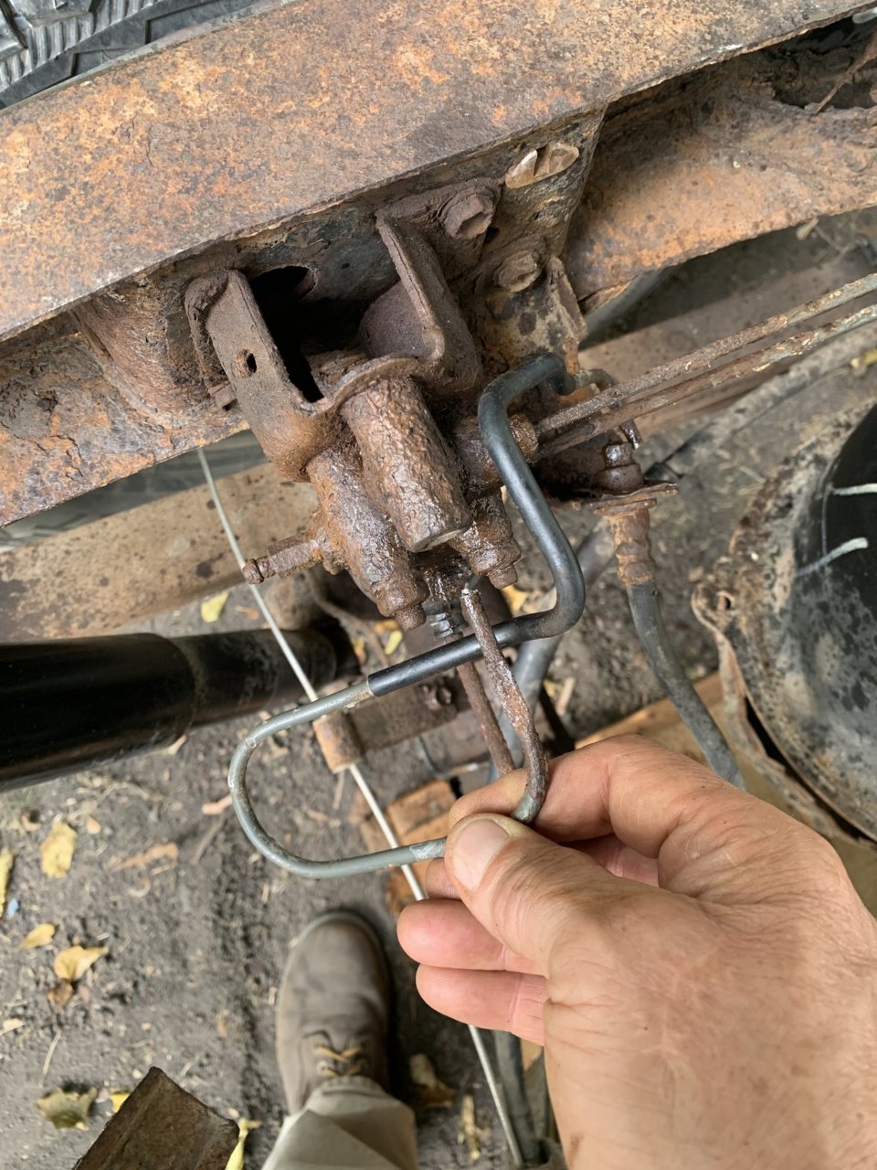

    I bought a 30” length of cu/nickel and bent the one by hand that was leaking. The original line was 21” long. Just made it longer. Would a longer line in any way affect anything adversely? I had to cut it out with a saws all blade hooked to vise grip as the threaded fittings were too damaged to get a wrench on them so then used a 10mm socket on one and hammered a 9 mm socket on the proportion valve fitting. Worked better than vise gripping them off. It ran from the rear proportion valve to a coupling body mount on the frame which then continued with flexible hose to a tee feeding both rear wheels. I questioned auto parts guys why Toyota had these bends and a coupling connection point when in my mind why didn’t they just run a braided line straight from the proportion valve to tee fitting bypassing that coupling connection. They couldn’t tell me but we all figured there was a reason. One guy told me you should change brake fluid every couple years as it breaks down and can rot the lines out internally too besides road salt rusting the outside.

    Just removed the two 10’ rusted hard lines that ran along frame to back of truck as one of the line connections started leaking. Bought a 25’ roll of copper/nickel 3/16” line and 4 M10 x 1mm fittings. Had to order a double flare insert to use with my single flare tool. Since Im not a mechanic and have done very little mechanic work it’s kind of exciting to do. YouTube videos are a must for me. going to replace brake pads and have rotors turned or replaced if need be. Hopefully I can get them off. You’re an inspiration ControlCar!

    Now I have learned about what the purpose of a proportion valve is in a brake system which helps me understand the installation of an “old fashioned” wilwood style valve. If the rusty stock one gives me problems I will repipe in one of those. No different than a manual damper system in ductwork to divert air more or less to a space. Thanks again.
