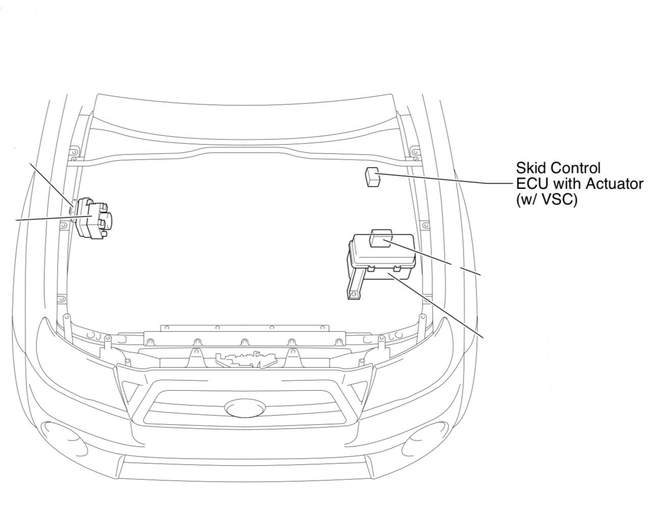

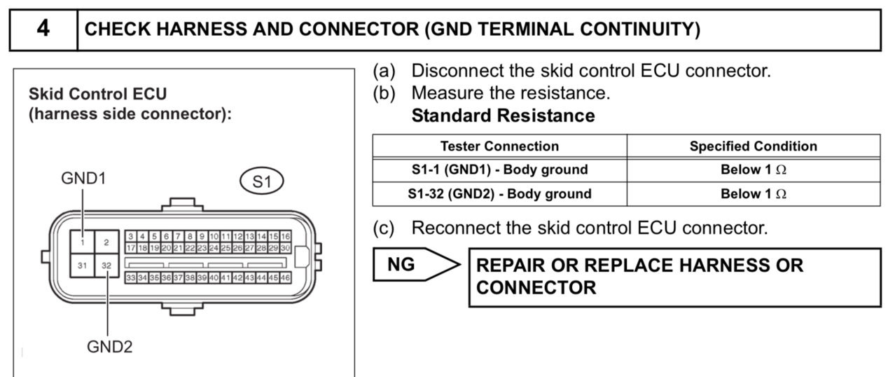

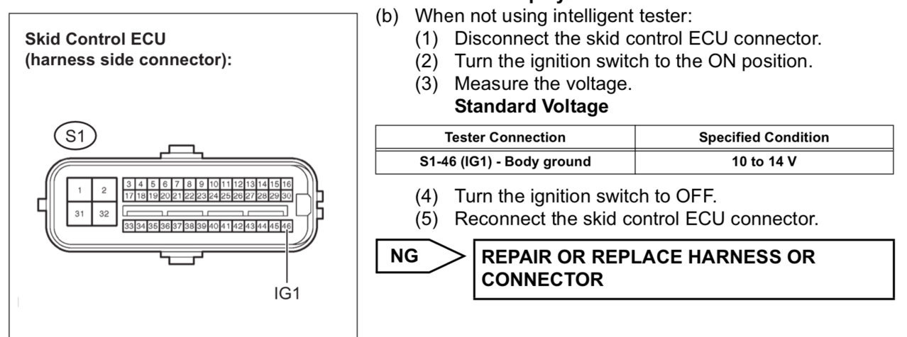

    I’d start with the easy things first.
    1. Check your battery voltage. Then check the Terminals.
    2. Check the IGN No.2 Fuse for corrosion or loose connection. - Doubtful that is it. But it’s worth checking.
    3. Check the voltage at the IGN No.2 fuse (more than 9.5v - but battery voltage is what it should be)
    4. Next jump right to the Skid Control ECU. Same thing here check voltages and grounds.
    I believe skid control ECU is right by/on the masters cylinder on the VSC truck?
    I might be wrong, I don’t have VSC. So I can’t confirm.
    624C542C-1400-4DBB-9844-5970956F9588.jpg A00C24AD-8BA4-4029-AB02-453F54CE90B2.jpg2930265E-10B4-44D5-871A-D2A23367A11D.jpg

    JaCado, abs unit is on right side on my 2010. But info and connector should be same. Thanks. But I think the code refers to ign1.

    It’s the IG1 pin of the Skid Control ECU. That’s what it is is saying is receiving Low Voltage.
    The fuse is just a path to the pin. So, it should be checked. Even though that’s probably not the cause.
    My bet is a bad or loose connection.

    Well gentlemen…14.7 volts at ign 1. Grounds good. So…left abs connector disconnected, backed about five (5) feet. Clunk clunk. Beginning to think differential problem.
