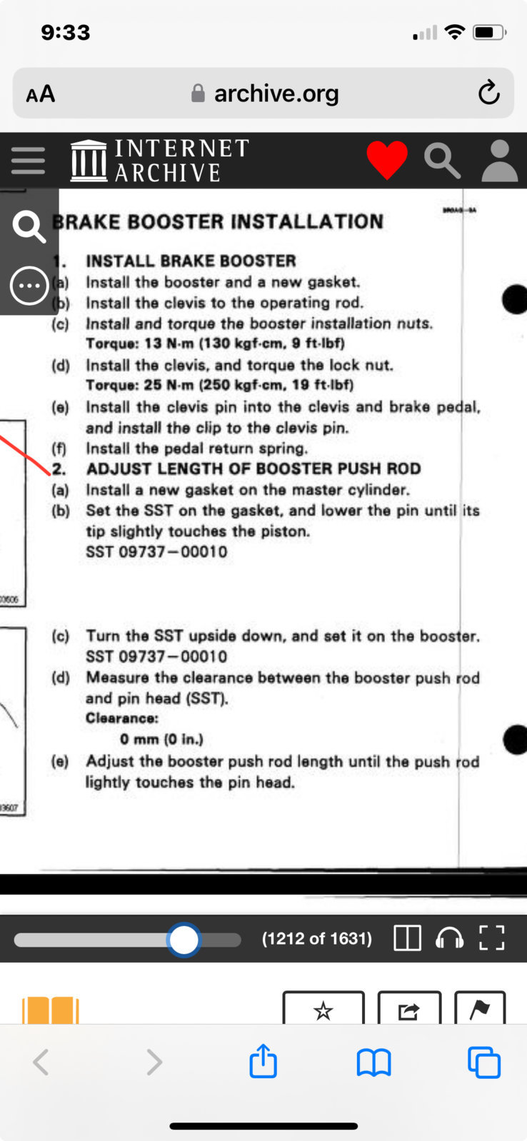

    IMG_4241.png From 96 manual mind u

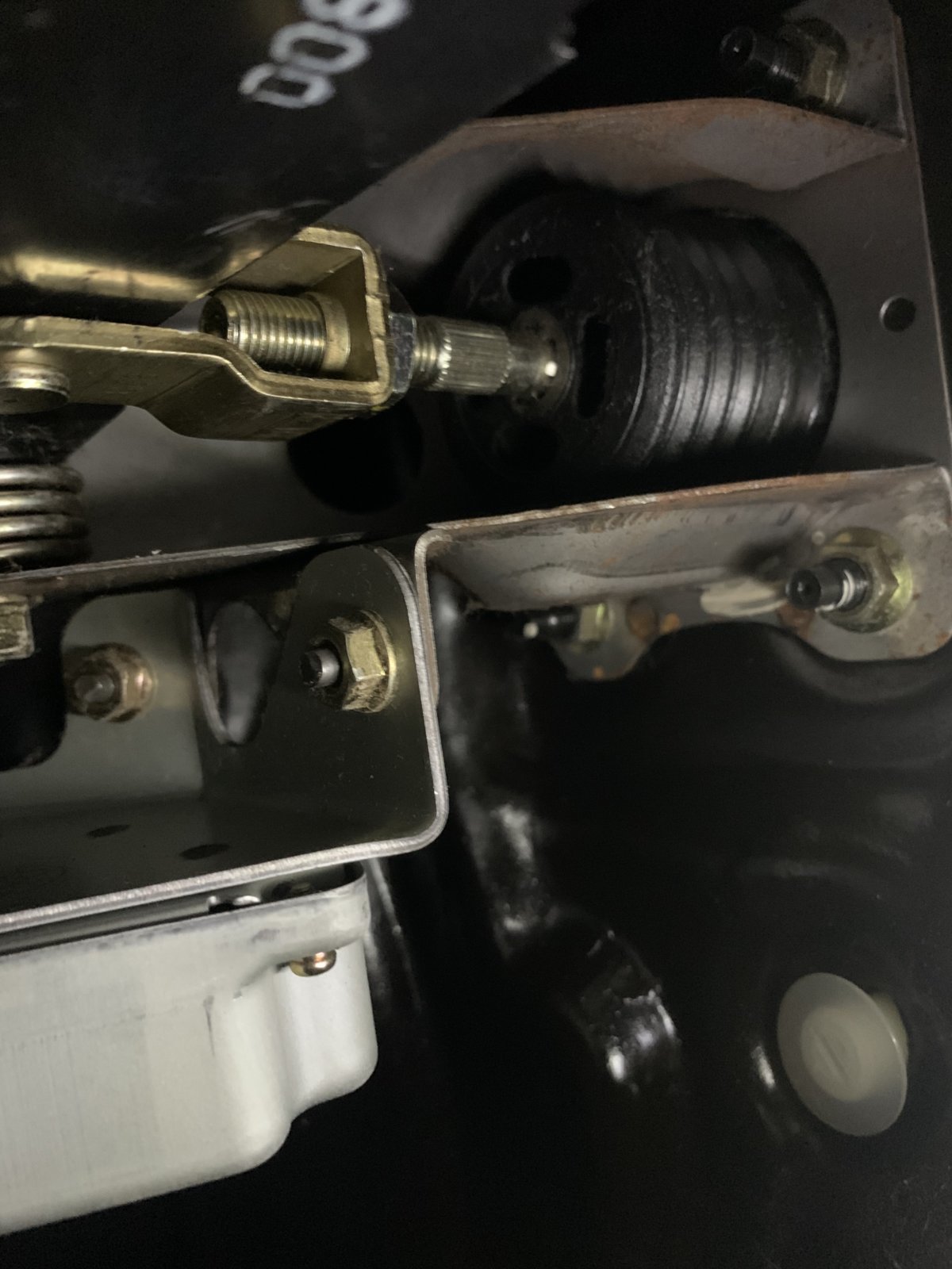

    After^^^

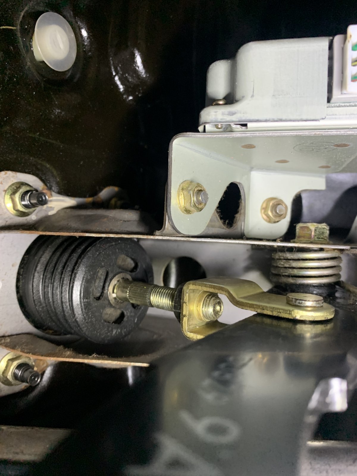

    Not exactly the same but this is Subaru adjustment before and after
    Before
