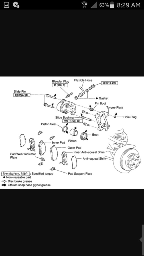

    They will be something l like #88. If there is any build up (rust) it need's to be cleaned off. Then lubed then slid back in. Screenshot_2017-07-15-08-29-06.jpg

    Make sure to add lube to the pins.

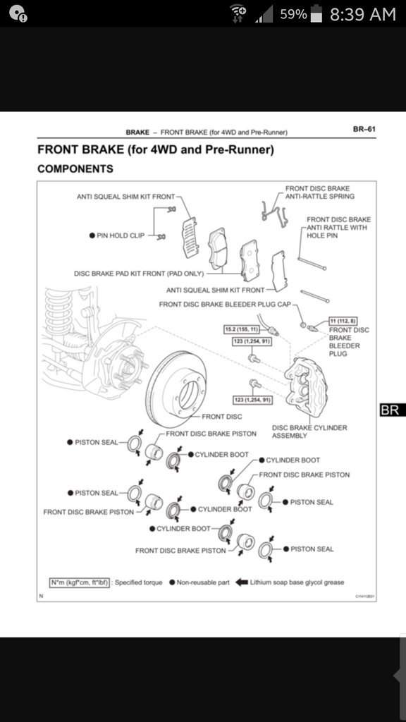

    And see the anti rattle shim. That MUST have lube on those l. On the back of shim. The part facing u. Also MUST have the anti rattle spring in place. Screenshot_2017-07-15-08-40-00.jpg

    Be sure those anti-rattle springs are in properly.

    Did you lube the slide pins and the back of the pads? Check the squealers and also the spring that goes between the calipers. You may have put it in upside down and it's hitting the rotors and squealing in reverse.
