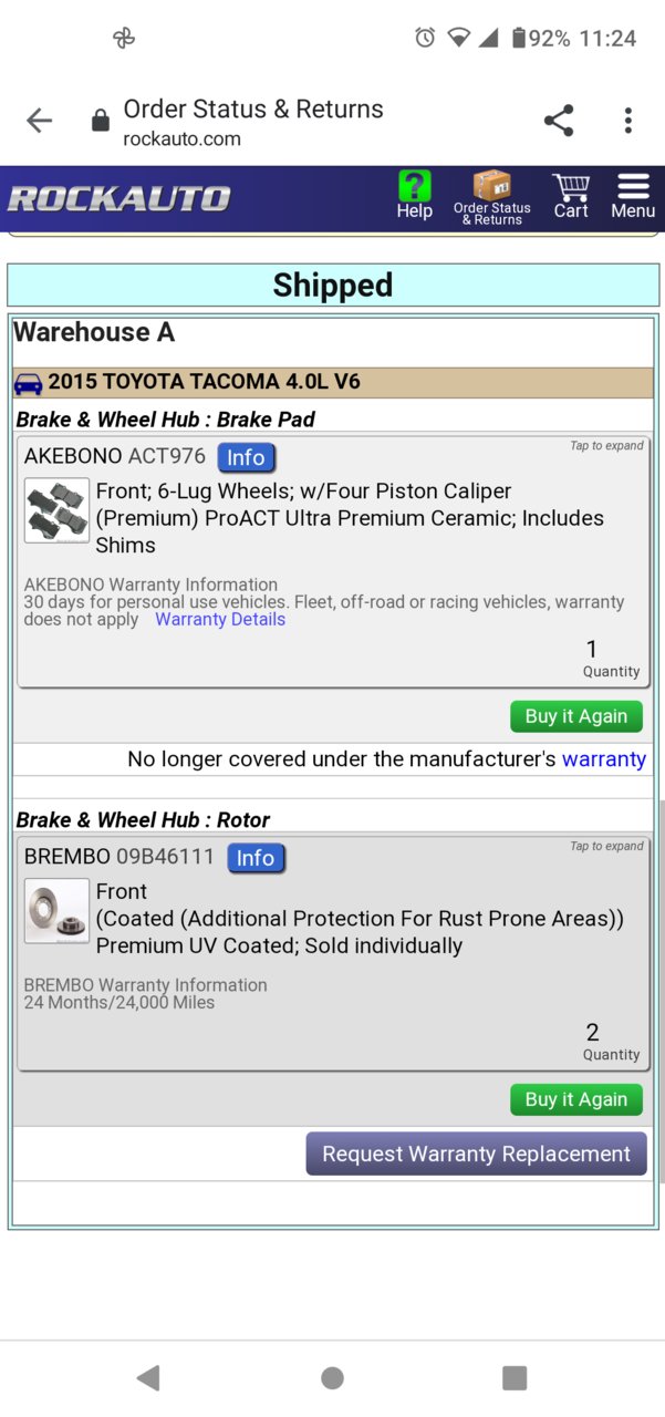

    Akebono pads, brembo rotors. Order and installed about 13 months ago.

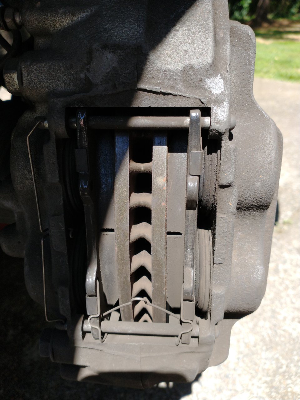

    Definitely not worn. Pins move freely. Wheel spins with no resistance so I don't think a caliper is stuck.
