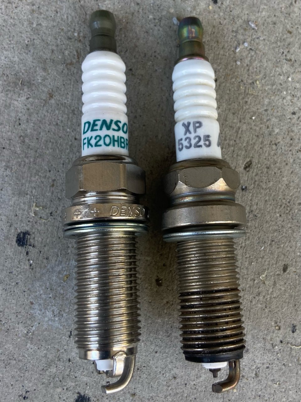

    Problem solved! My C.E.L. and brake override malfunction issue started a day after I replaced my spark plugs. I told the toyota dealership that the problem could have been caused by the spark plug change. They didn't listen what I had to say, they had my truck in for diagnostics for 6 days, then told me I needed a new throttle body for $1,200. I replaced the throttle body myself but it did not fix the issue. I decided to re-do my spark plug change with the OEM spark plugs rather that the aftermarket Autolite iridium xp I put in before this problem started. This fixed the issue!
    In summary my engine malfunctioned due to not having compatible spark plugs. Use OEM spark plugs! Even tho these spark plugs were supposed to be compatible with my engine, according to autozone and my research, they were not.
    *OEM left, aftermarket Autolite right

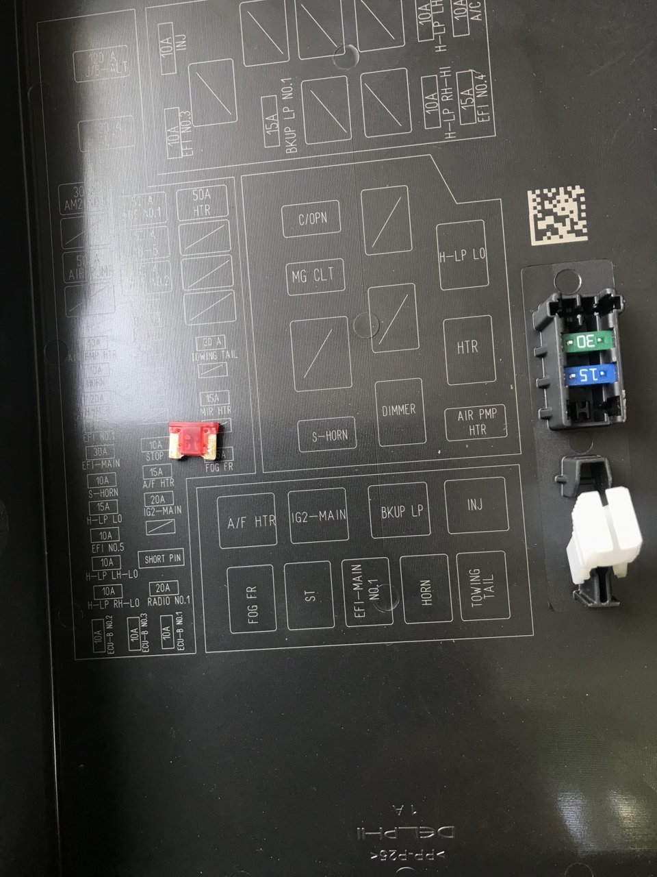

    Anyone have what might be a quick field solution to starting up the truck with this issue? Currently on a trail west of Lone Pine with this issue that won't start. Drove it pretty hard today, so I'm gonna let it sit overnight with the battery unplugged and see what happens. No transmission or engine codes.

    Check your fuses?

    Yea, thanks I'll check that STOP fuse in the morning after it's been sitting in the cold with no battery tonight. I drove a solid 5 hours in 100 degree heat today, so he deserves a break lol

    I did have a code reader and surprisingly had no codes. I went and swapped the STOP fuse this morning and thankfully it started up. I probably would have been panicking more if there were codes since I'm up a creek right now with no front recovery points.
    My first step probably was going to be to check the ABS sensors or something like that
