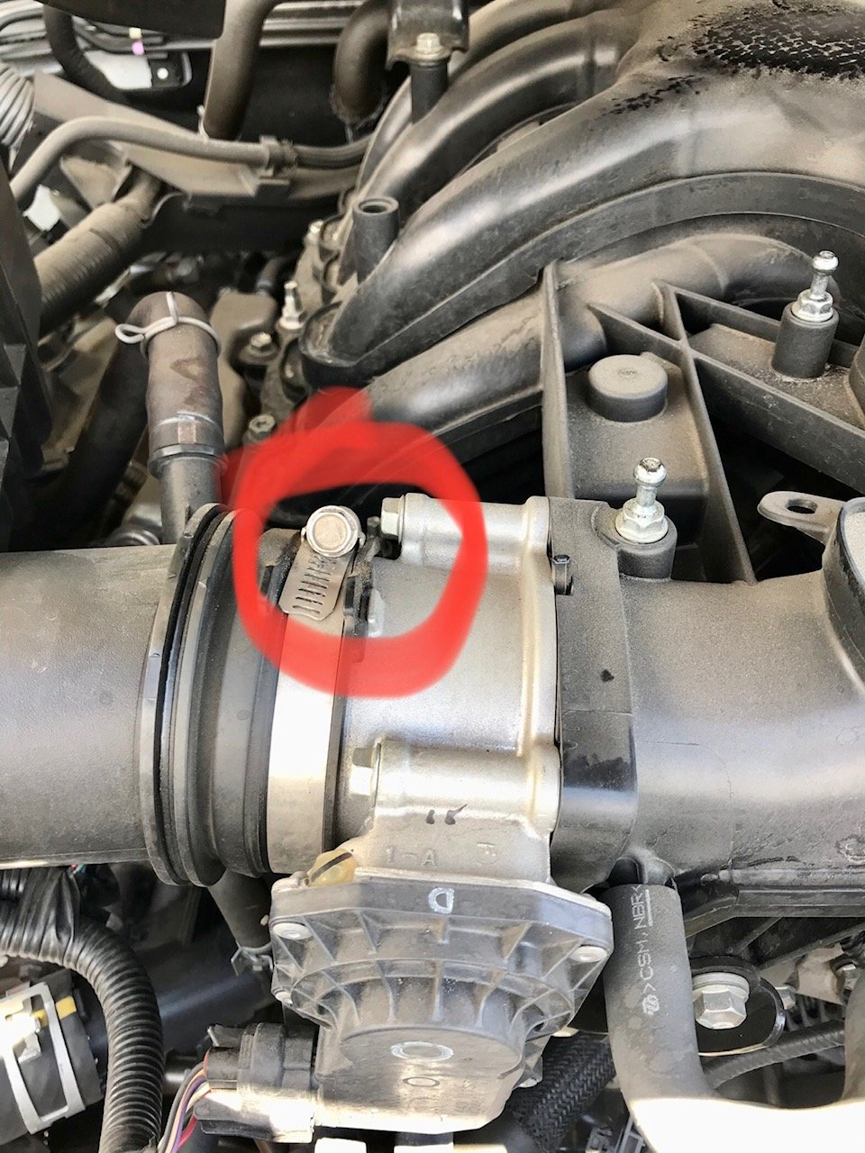

    Thanks for posting zcweisman, you replaced the fuse. Check the rubber manifold (from air cleaner) where it meets the aluminum intake - that clamp needs to be tight.

    I firstly removed air cleaner, made sure it was clean and set aside. I snapped off the plastic cover (where it hinges closest to the firewall) and removed, set it aside. You should be able to see the large rubber hose (about size of an arm) and where it meets the MAF's aluminum housing, this has a plug on the front - it plugs in from the left to the right. That clamp 'should' be tight. I found mine to be hand tight and immediately figured it was the source of a vacuum leak.
    Unbolt and remove the clamp (since you're there) and spray some MAF cleaner in the housing. Reverse the procedure and post report. NOTE: The Tacoma might take a little longer to fire up the MAF cleaner (I don't think) is not as volatile as gas, so keep that in mind.
    Uploaded picture of the clamp and bolt in question (07.18.2022).

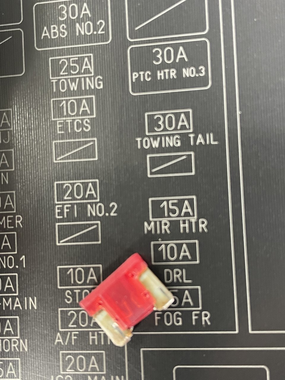

    It was the STOP 10 fuse. Under hood just replace the fuse in the main box and do the on/off 6 time cycle to reset the code. Good to go.
    Dealers like to say it was blown because of my a-rex LED tail lights. But they draw the same amount of power as the oem halogen lights do so I assume that's bs dealer talk. I'll now be carrying a bag full of fresh fuses with me just in case though. Cheers

    I just experienced this problem for the first time at 35,000 miles and the 10amp STOP fuse was the culprit for me

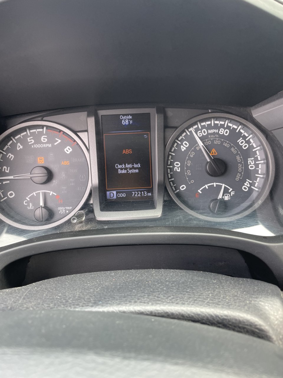

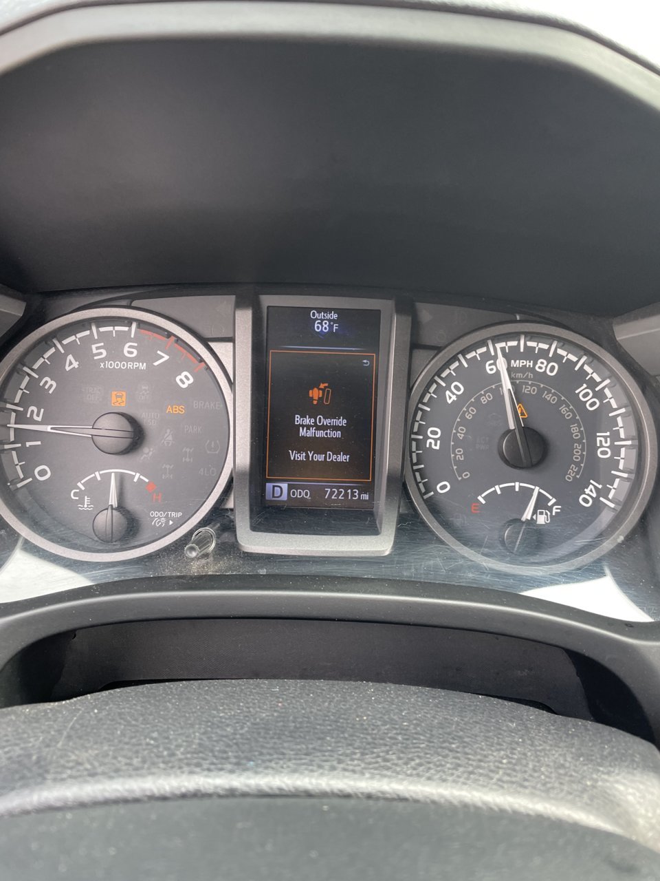

  19. Sep 17, 2022 at 7:57 AM
    #99
    nightcrawler
    nightcrawler Well-Known Member
    Apr 8, 2009
    #15733
    368
    ‘17pro
    10 amp was blown, got it to start after a few attempts, but did not want to shift out of Park, used that little button to release shifter. Just dropped it off at dealer. ABS light also on930D3118-9245-4664-A563-C18ECBEFC840.jpg0F959B38-3EE1-4836-B3BF-EDE6CF3BC756.jpg 6CBEA486-C725-499F-8C23-33AE59EB8A7C.jpg
