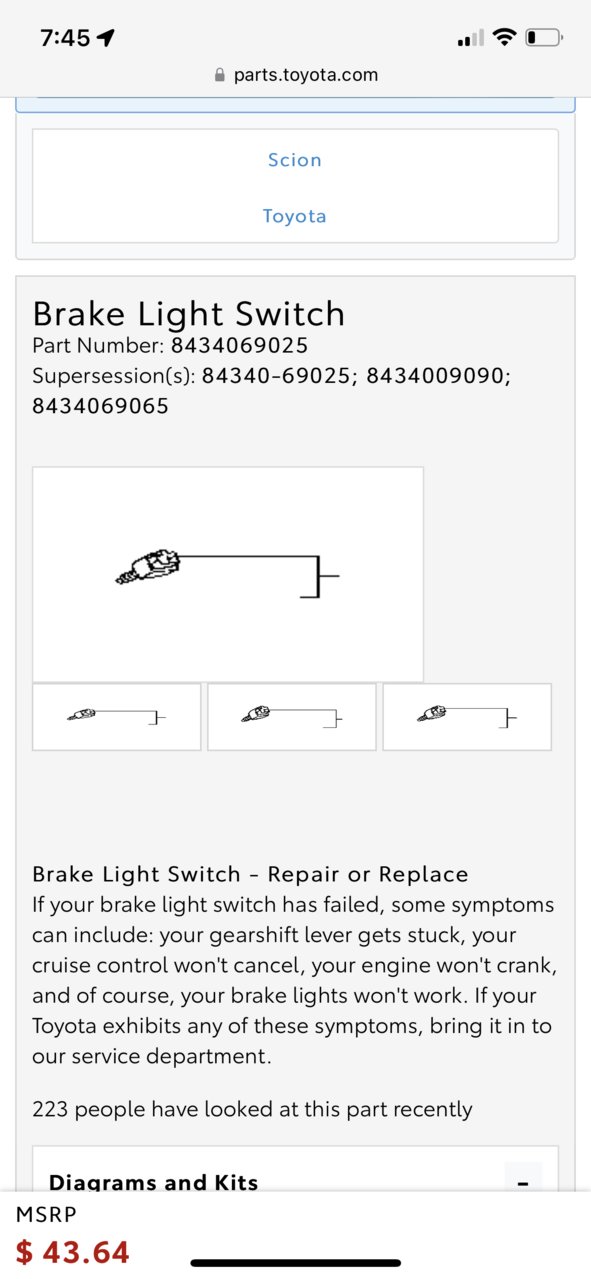

    Got the truck back, stop light switch assembly and a brake bulb was replaced. All good now.
  4. Sep 21, 2022 at 4:31 PM
    #104
    staplegun
    staplegun Well-Known Member
    May 3, 2011
    #56003
    241
    Good news! Thanks for posting the resolution...One question, the switch at the pedal proper?
  5. Sep 21, 2022 at 4:32 PM
    #105
    nightcrawler
    nightcrawler Well-Known Member
    Apr 8, 2009
    #15733
    368
    ‘17pro
    Yes the switch at the pedal

    Just an FYI, if you don't have a part number go to https://www.toyodiy.com/parts/ plug in your VIN and then find the part number. Once you have the number, plug that P/N into your favorite search and you'll find some wholesale prices from dealers on the www. In the example above you can save over ten bucks...

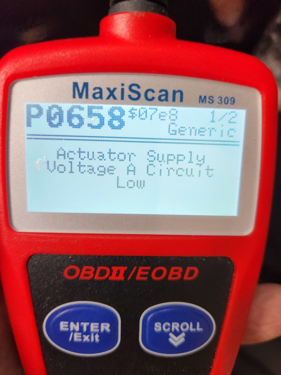

    20220923_170738.jpg Brake override malfunction happened to me yesterday. No led taililights or anything. Just a 2 inch lift, gearing, pod lights and an aftermarket stereo system that was installed over 3 years ago. Truck starts everytime but it's in limp mode. I live on a hill and needed to put it in 4lo to get up my driveway. Now its stuck in 4wd. I did disconnect the driver door beep wire years ago. I'm just out of the basic 3 year warranty. Having it towed to the dealer Monday. Stop fuse is good. Does the 5 year powertrain warranty cover this. The truck is undrivable as is. 38k. Thanks.
