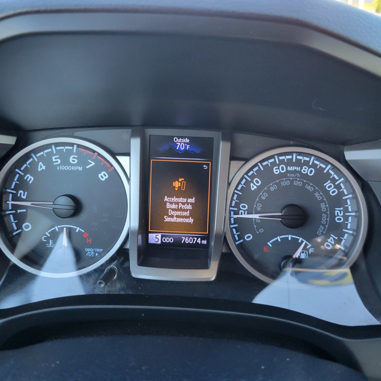

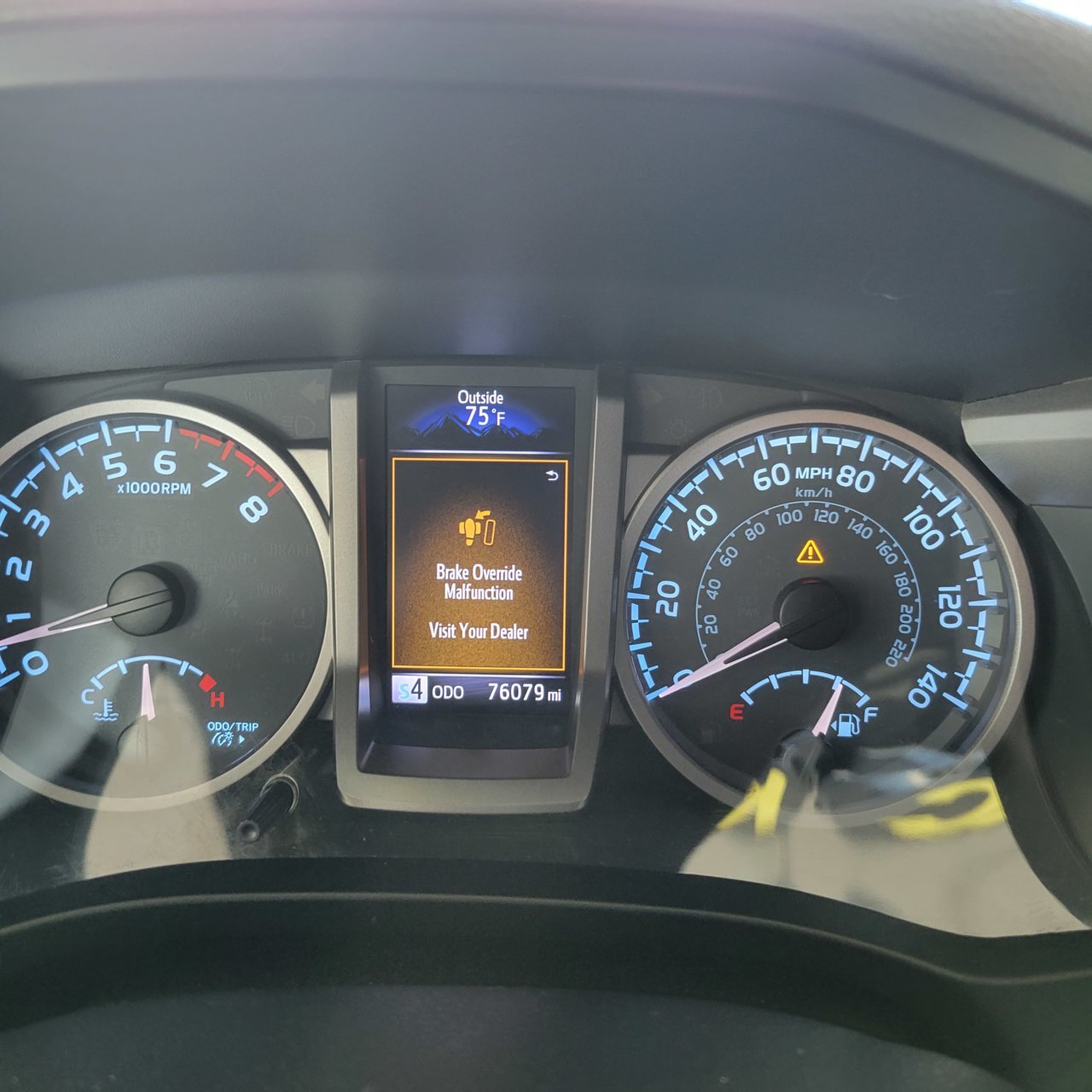

    Both warnings came in this morning. Second one also made the truck slow down. I believe the computer was applying the brakes. As my truck felt like it was stalling. Got it to the dealer. Now the fun begins.
    Anyone ever seen this?

    Page 44:
    "Smart Stop Technology automatically reduces engine power when the accelerator and brake pedals are pressed simultaneously under certain conditions.
    SST engages when the accelerator is depressed first and the brakes are applied firmly for longer than one-half second at speeds greater than five miles per hour.
    SST doesn’t engage if the brake pedal is depressed before the accelerator pedal, allowing vehicles to start on a steep hill and safely accelerate without rolling backward."
    I don't see anything about it throwing a code though. Sounds like something is wrong with the SST.

    OP, it’s a blown fuse. There is another thread about this that has the solution. 10A STOP fuse

    Update.. just picked up my truck. All seems good so far. They said there were many codes they traced to a "shorted taillight bulb" that sent bad signals to the computer thinking I was braking while my foot was on the gas. Other than the fact that my taillight was still loose when I picked it up...pretty happy with easy fix.
    I recently had my bed off and lots of work done so who knows what caused it but possibly during the work that was performed.
