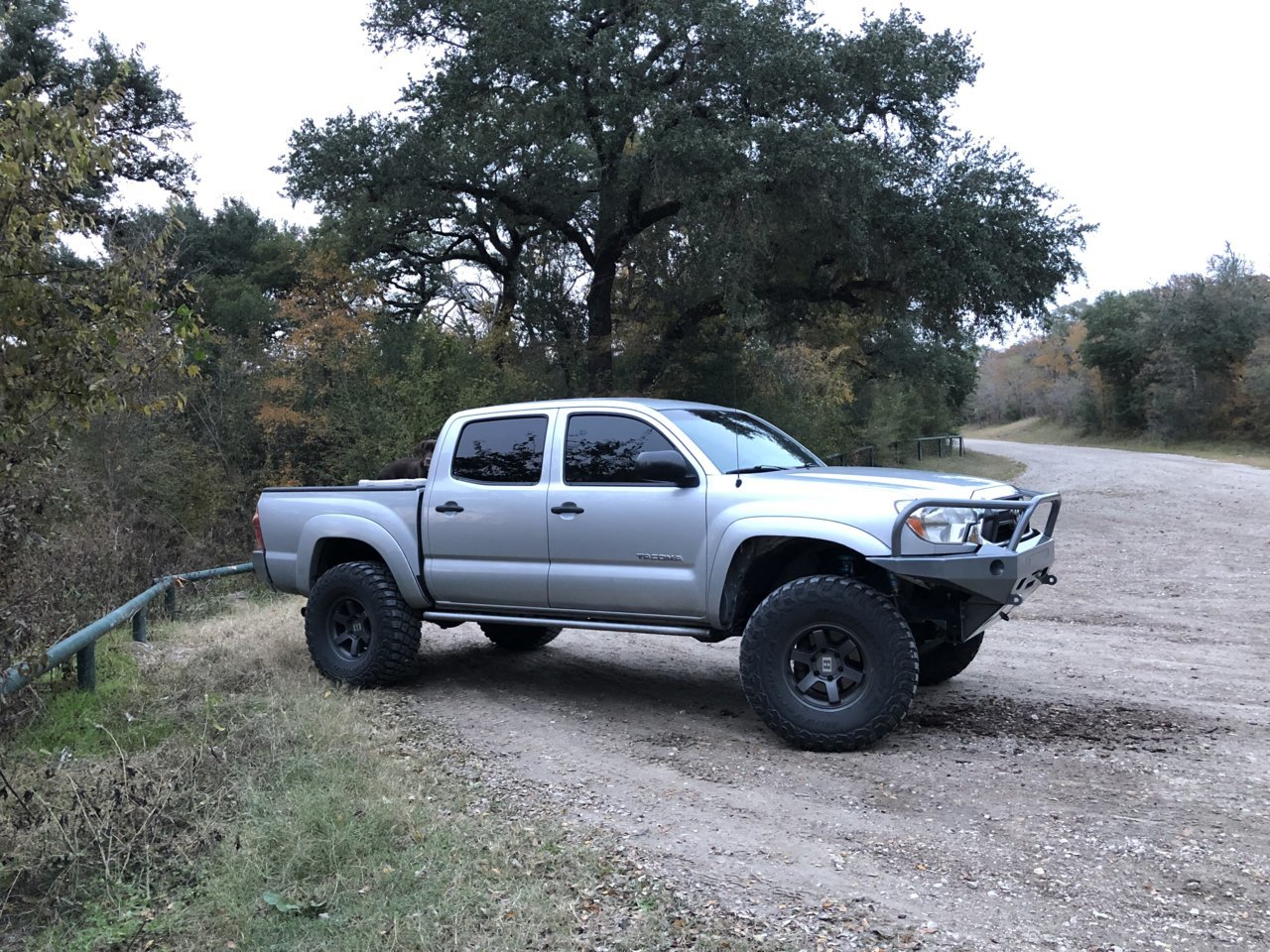

    I recently replaced my factory pads after 105k+\- miles. Went with the TRD brake pads, and my factory rotors were still perfect. The pads are an upgrade in performance and have no issue stopping my heavy truck(35’s and steel armor).903235FE-3F35-480E-ACE2-981D9EE826B0.jpg
