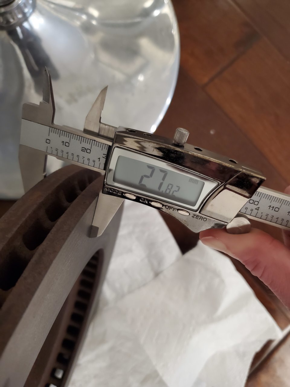

    Bring your own micrometer. Ask to see the rotors. Measure them yourself. Always ask for your old parts back. Measure them right there on the counter. The spec is stamped on the rotor.

    Looks like you have 20K left on those pads and the rotors look fine.

    We can see one pad in the pics, which looks healthy. If the other three pads are similar you have plenty of time. If your pedal is giving you pulsing when applying the brakes, th only good long term solution is new rotors.
    id ask the shop for measurements on the rotors and all four front pads. I’m at 65k on my taco and nowhere near ready for any brake work.

    According to the service manual, the brake rotors are 28.0mm thick when new, and need to be replaced when worn down to 26.0mm thick. Can't tell by a photo. Need to measure with a micrometer.
    Most shops don't keep a brake lathe, since replacement new rotors aren't expensive.

    Brake pedal wasn't pulsing. But Ive been noticing some vibration at 60+ mph on the freeway, and that was from tire balance (tires and wheels are not original) which they did yesterday at that shop. They did paint the rear drums black when doing the rear adjustment (which now I know was another $50 wasted), the drums were pretty rusty on the outside, but is the coat of paint recommended/something that is typically done....did I at least get some money's worth on that part? (assuming the paint lasts and I'll never worry about corrosion on those drums ever again)
    Definitely a lesson learned, guess I was stuck in "2002 ford explorer" era.
    Either way Im thinking about emailing the owner of the shop these pictures and explaining the service writer told me that I absolutely had to replace the rotors, and he didn't really leave me any choice. That's definitely never happened to me. I went there only because I made the wrong assumption that my pads were very low, so my plan was just a quick replacement of only pads. Do you guys think it's worth sending an email and trying to get some money refunded? I also want to verify they used Toyota oem parts only, because that wouldn't be good if they lied to me about that part, so I may ask for pictures of the Toyota boxes they keep in stock.

    Simple man's first test...if the vehicle shimmies when coming to a stop, particularly at say 50, 40, 30 MPH, the rotors are warped from heat induction and cyclic use. Time for one of two things; 1) replace the rotors because they are warped and new pads won't do well on the bad rotor, or 2) have the rotor turned to a flat (zero) run-out surface, however the rotors are now thinner and subject to warping again, sooner because of a thinner (turned) component that will not absorb heat as well, thus warp again, sooner.
    To your point, your pads look good from your photo and during that observation, the rotors look good, i.e. no gouges from worn pads, etc.

    The service writer basically told me they wouldn't put those original rotors back on after removing them and had one on the lathe. They said it would be "far out of spec" to complete their machining. Clearly the rotors were fine. So they tricked me, then charged me a rediculous amount for the labor I never imagined they would charge for that job. They told me I HAD to get new rotors. So I think this is grounds to get some money refunded....

    That rotor looks like it was already turned and is within spec which is 26. The pads looked very thick. I couldn't see any reason to replace them. I think you have been taken advantage of. I would have a serious talk with the owner after I disputed the charges.

    I agree - Pads look fine - lots more available material. If you do not have issues, you did not need brake work...
    I usually replace pads and leave the rotors alone (when not having wear or warp issues). Metal mass is what disissipates heat... which is what makes brakes work.
    I prefer to not turn rotors - ever. If your rotors NEED turning (- they should not..), then REPLACE THEM!
    If there is a vibration issue, it is likely due to overheating, likely at least partially due to worn rotors. If this is an issue, then simply REPLACE!
