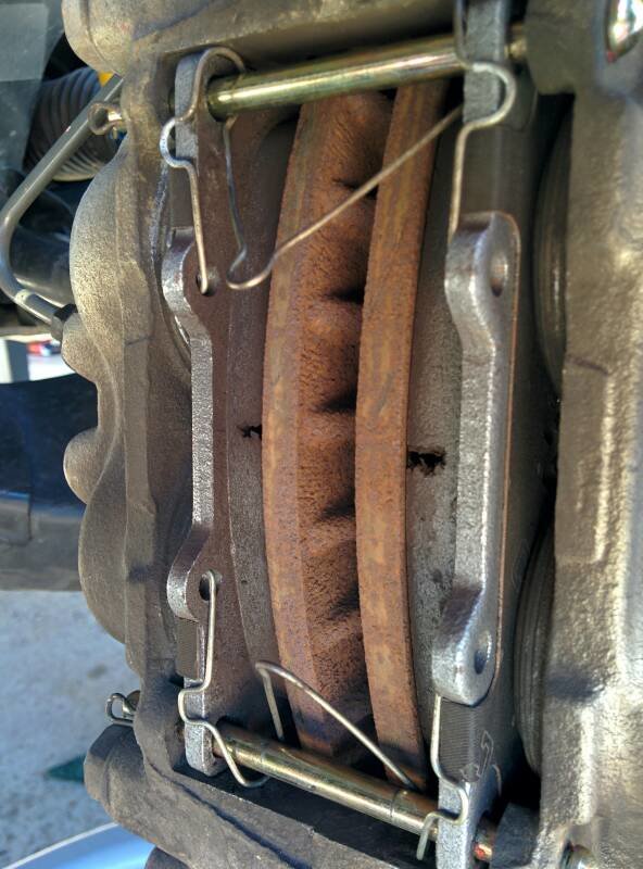

    Yesterday I drove it hard and was braking hard and experienced it. I'm thinking for sure it was the EBA feature. My truck is heavy so it must be the weight of the truck, and the skid control ECU engaging the feature.
    Today I had the front wheels off, so I cleaned up the pad pins and added another spring to the caliper. Pads looked good and wearing evenly.
    At this point, I'm not concerned. Thanks.
