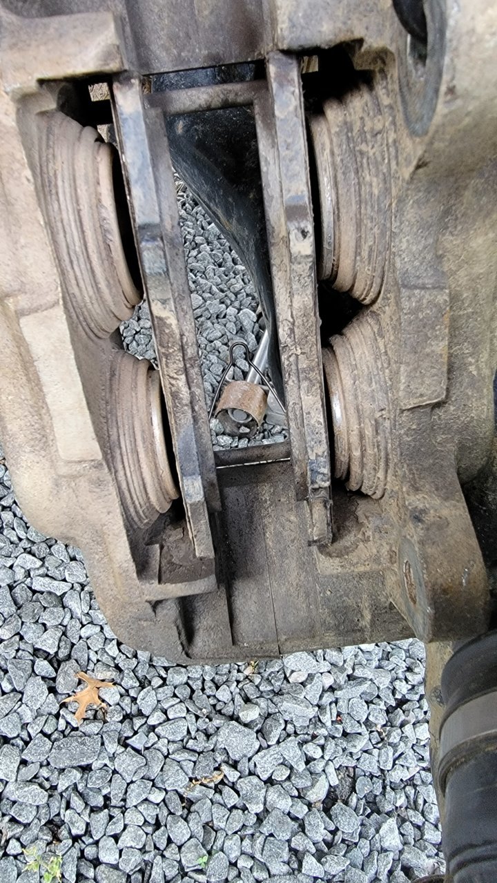

    Just looking for recommendations and input for brake pads and rotors for my taco. With only 15k miles on the truck, the pads are already worn pretty well. I don't drive too crazy, but I do my fair share of off-roading in the mountains and my truck does carry around a lot of extra weight (skids, sliders, bumper, etc).
    For the pads, I was thinking of getting Akebono performance pads.
    For rotors, I'm a bit more torn. The stoptech slotted cryo rotors looked great until I saw their price of $250 a disc. I'm confident that I want to get a slotted rotor vs non-slotted or slotted+drilled, but don't know who else makes a quality slotted rotor for the tacoma.

    I didn't measure them, but you can look at them yourself. They still have life, but I'm trying to get ready for a 3-week/6000-mile trip this summer and don't want to have to be worrying about brakes.

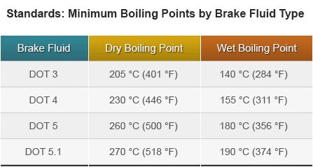

    Our trucks come with DOT3 but upgrading to DOT4 or DOT5.1 is a good call because they have a higher boiling point. Anyone else reading this though DO NOT PUT DOT5 in a tacoma.
    I've actually managed to get the pop-up warning message saying my fluid has overheated so this was an upgrade I was going to do anyway.

    DOT 3, 4 and 5.1 are all glycol-based so technically you can mix them but it generally isn’t suggested to the general public because it can be easy to goof up and drop on DOT 5. The only real difference between 3, 4 and 5.1 is their boiling point.
    DOT 5 is silicone based and does not play well with others.
