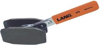

    I found that out the worst way possible a couple weekends ago changing the brakes for the first time on this thing. I popped the reservoir cap off, got a c-clamp and pressed the first side pistons on the drivers side caliper... and the opposite piston shot out onto the ground. Truck is now peeing brake fluid everywhere. Stuffed it back in but of course the seal was ruined. Next time I'll open up the screw.
  10. Aug 6, 2022 at 6:59 PM
    #50
    RustyGreen
    Aug 12, 2020
    #337468
    14,893
    sleeping in a chair
    2017 AC 4x4 Sport 6M Inferno
    Pavement Princess
    Next time try one of these, does all the pistons at once.
    https://www.langtools.com/sku-279-brake-caliper-press/
