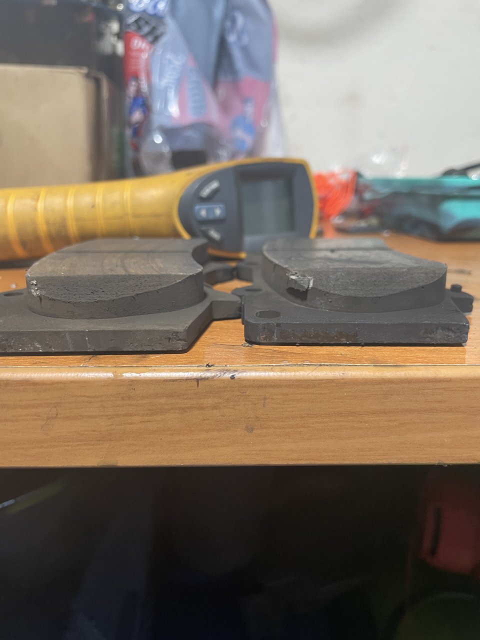

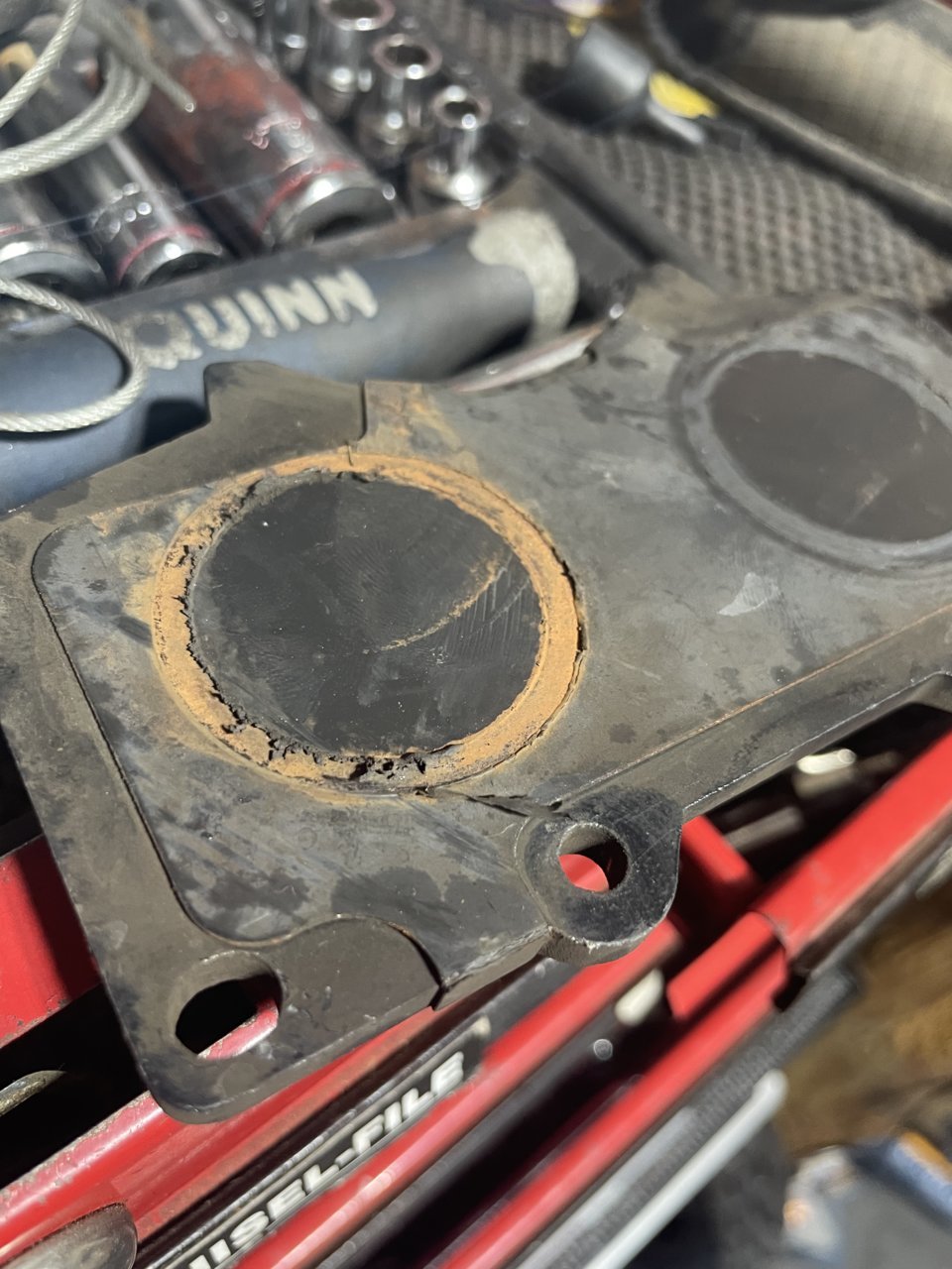

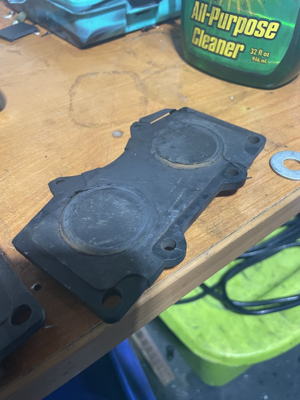

    also attached picture of brake pads and does anyone know why the pistons melted the shim never seen anything like that before??
    Hope this all makes some type of sense and not all over the place Thanks in Advance

    My 2011 did the same things with replacement pads. The steel edge of the pads rusted I had a hell of a time just getting them out they were bound on the edges of the pad still had plenty of pad just a shity pedel. I went after the caliper removing rust where the pads fit into the caliper the rust was from the pads not the caliper. New set of different brand pads no problems since.

    i agree with you that the pads are uneven and wearing different the outside pad is the one that is wearing kore then the other

    Look for uneven pad wear. Inboard pad vs outboard and also side to side of the vehicle. That may help narrow down which caliper (or pad) is sticking
    Pull the pads out and look at the caliper where the pad end butts up against it. Look to see if the pad has worn a channel or groove in the caliper
