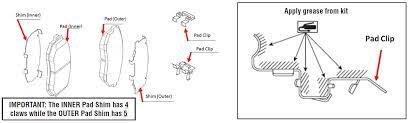

    Are you still using the StopTech pads through all of this? Maybe you mentioned you ditched them and I missed it. I had them on my truck and their behaviour was....odd. I have used them on LOTS of other vehicles and been perfectly happy with them...but my truck wasn't a great experience. Stopping was like turning on a light switch...but it only seemed to be that temperamental after driving for a while and letting the pads warm up. My theory was the pads just got crazy grippy after they warmed up. If you have ever driver a set of race pads on a proper prepped race car you will understand what I am getting at...they just have no grip until you can smell them.
    I went and grabbed some Akebono pads from Napa and the behaviour went away. https://www.napaonline.com/en/p/AKEACT906B?impressionRank=5
    One other thing I had on a set of Brembo's. The pads were rubbing up against the caliper body just enough that they weren't releasing freely. Maybe pull them out and grind off a bit (just a real little bit) of the ears on the pads on the side where it seems to be hanging.

    with the caliper off the truck try reloading them with pads and pins (no springs). If you can't move the pads REALLY freely on the pins that's a problem. The solution might be as easy as shaving down the backing plate some with a dremel. It worked on my STi. The pads were all sorts of hanging up and it turns out the bonehead that installed them...(me)...just shoved them in there and didn't make sure they were free floating.

    @toytaco112 try some brake lube on the bottom outside edge of the pads it's a common fix for sticky subaru pads. I keep meaning to do this to mine but keep forgetting.
    to clarify further the pad lube goes in the edge that drags on caliper at very bottom not the braking surface of pad.

    Well pulled passenger side did not see anything damaged pulled brakes and caliper and reinstalled made sure they slid back and forth on the slide pins which they did. Took a file and removed all dirt and red paint(stoptech calipers) where the pads slide in took a drimel and cleaned up around edges of brake pad reinstalled caliper and greased all parts slide pins and the little ear on pad put all back together. And did the same thing to driver side….
    Took for a 20mile test drive and no issues so far hopefully this works.

    Yea I tried the 2 spring with no luck I think the pads just had a little edge on them and with the red paint peeling the pad was catching and not releasing all the way at least thats my theory but we will see if it works or not
