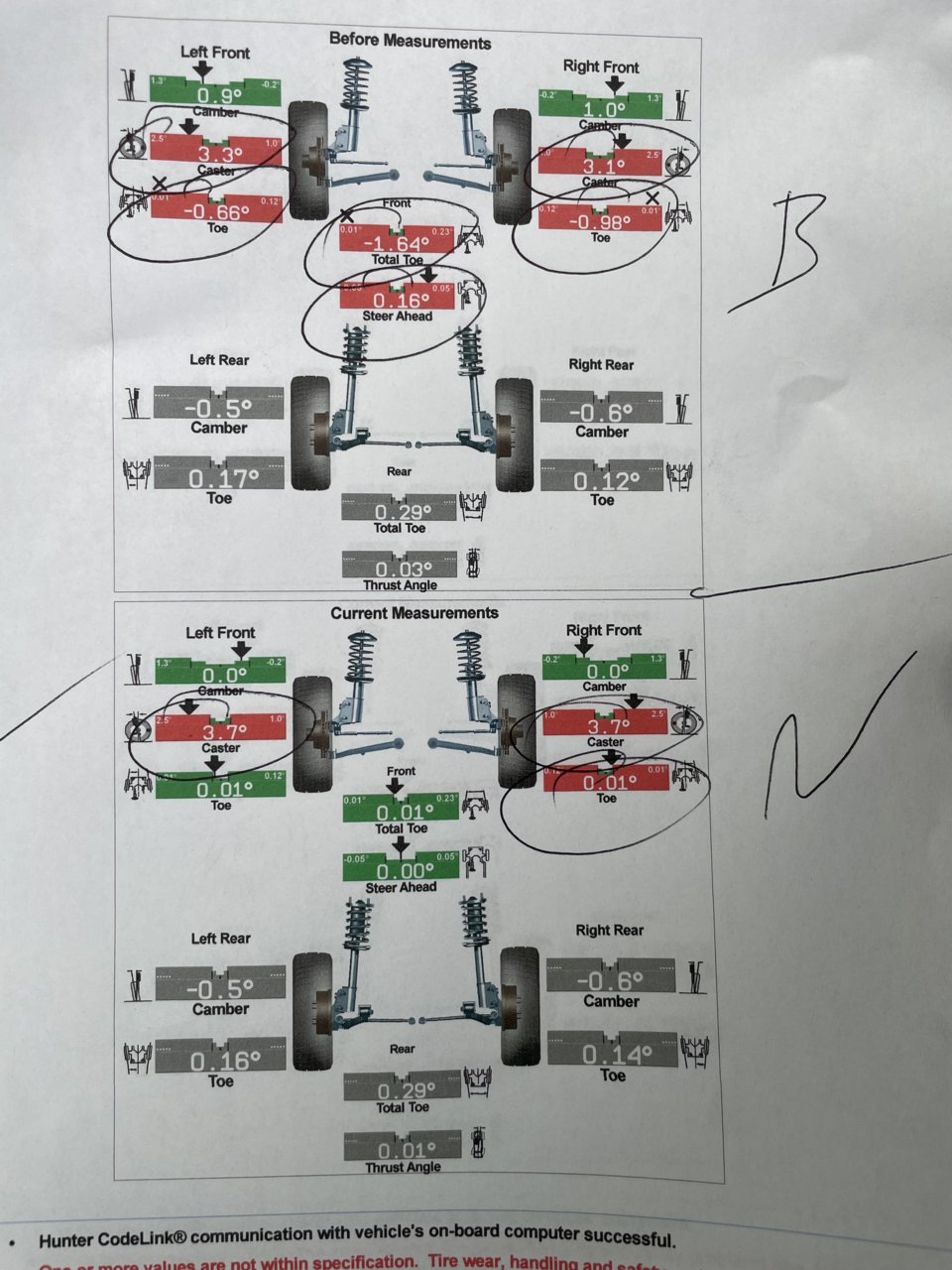

    Finally figured out my issue Feel kind of dumb now. So my issue was the Lower ball joint castle nut that has the cotter pin attached to bracket that attaches to spindle was loose. I retorqued every bolt on the entire front end a couple times except that bolt because I kept telling myself it has a cotter pin it cant be loose. Should of Known. Every time i jacked the truck up everything was good which now I know why....
    Only found this out because i replaced my LCA's thinking maybe the bushings were bad and when i went to press the bracket off the driver side ball joint i barely put pressure on it and it just fell off scratched my head like thats not right. Did the passenger side and it took quite a bit of pressure to pop it off.
    Anyway replaced both LCA's OEM torqued everthing Got alignment which i was amazed by the results and boi does the truck drive and handle so much better.
