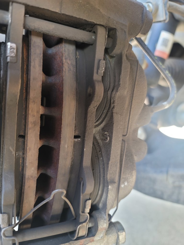

    What you guys think? Is it time to change the brake pads?

    Thanks, got 75K on it.

    Run them until that little grove in the middle of the pad is gone, then change them.

    75k? Must be them TX / NM / AZ miles. The rotors barely have any rust!

    In the Phx area with mostly freeway driving and have 104K on original pads and still not worn to where they need replacing. And that's with 285 E loads it's entire life. I've never own another vehicle that the front pads lasted this long.

    You're good, I would just clean them and grease the back of the pads and the pins and call it a day.

    Looks like the left side in the pic is wearing and slight bit more that the right. When the grove on the left one is worn down change both sides.
