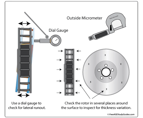

    Medium Hanging Fruit: 2nd take apart. Consists of measuring and testing. All numerical values are taken from the Toyota datasheets for my particular truck model.
    1. Rotors: The current rotors I am using are from Link. NO DIMENSIONS DATASHEET IS AVAILABLE. MUST MAKE SURE TO DOCUMENT MEASUREMENTS!
      • Measure:
      • awE2X_eQcPm0fC5LcBPGNDsgbV2_ho2abFg_O8Qk_b0ba521746ffbd08c019721a335827c9ae782238.png
      • Standard rotor thickness: 22mm (0.866”)
      • Disc runout max: 0.07mm (0.0028”)
      • Compare both thicknesses of rotors.
      • Dial gauge inside of rotor. The part that touches the hub

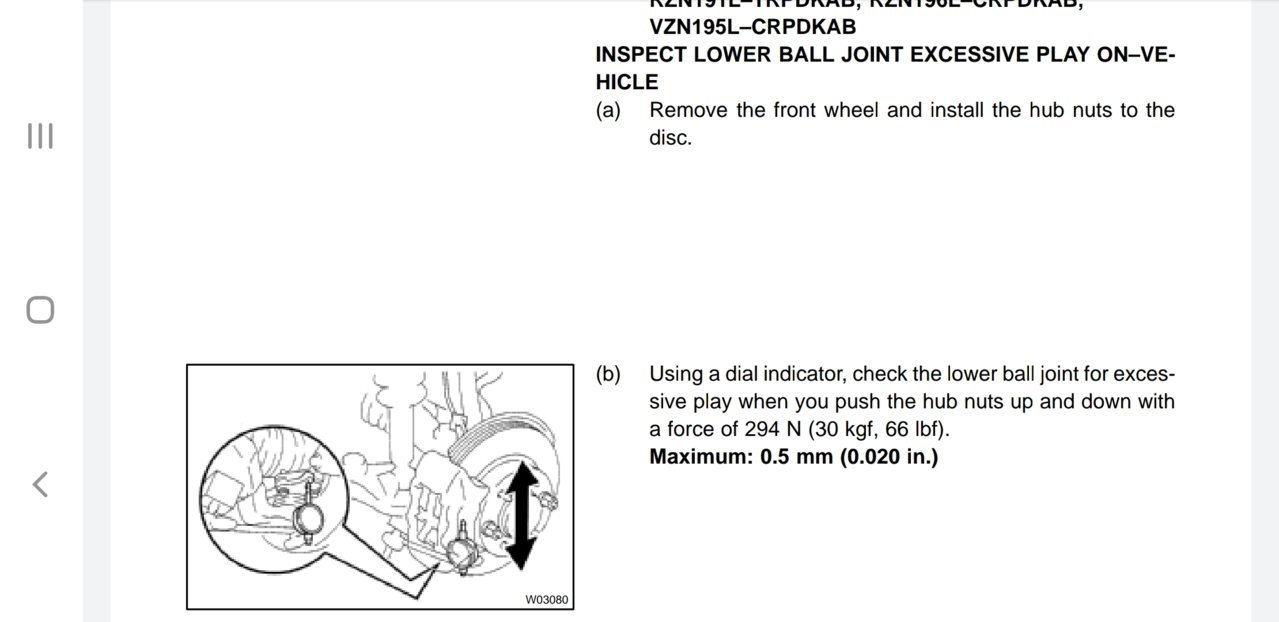

    @safes0c that is a fantastic write up ..and it's only for what you're planning to do! Hats off to you sir!
    The only thing I would add or do slightly different is for you ball joint check. As you plan of attack shows, you're quite the thorough person and might appreciate this. Due to the design of the LBJ the FSM has a wierd way of checking play.. I apologize for the crappy picture but my phone won't let me share the actual document
    safes0c[OP] likes this.

    Right on I appreciate the info! I was just going off of a random youtube vid of a Ford Ranger. Good to know!

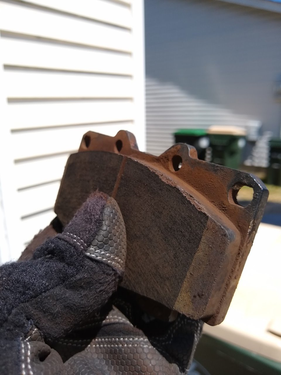

    So, I only had enough time to inspect the driver’s side front tire. I immediately noticed that when turning the rotor by hand, the resistance would increase dramatically over a certain section of the rotor. I inspected and saw the outside pad looks like it was dragging the rotor on that particular section.
    Fortunately, I did come across what looks to be a de-lamination of the rubber boot on the caliper piston. This piston is the lower one on the outside side of the caliper . There was no brake fluid leakage. Sax39m_pzrMSgm7AlgbvhpMxYeXXjTSC7UcixPm__e2fc27726c822ad42eec52b1ccfc741003aa2edc.jpg
    In addition, the brake pad area that makes contact with the problem piston had a decent chunk ripped out on the edge. This further evidence warranted more investigation.
    c0l7lX2yGXBJv28zD8pzQksueJSsbKEgCU8O8BRO_30bf8597e97a2380fca83463664c4bfb5bc25302.jpg
    From this point, I decided to push on with “med. Hanging fruit” measuring procedures. I also cleaned as much rust off of metal to metal mating surfaces of parts.

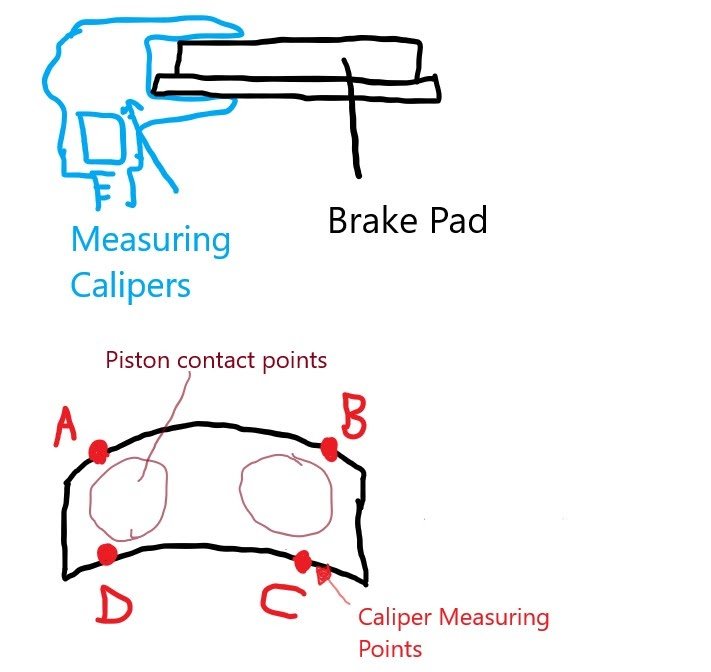

    Brake Pads Measurements:
    Measurements were taken on the brake pad thickness. Overall, both brake pads had ample thickness. The inside pad had slightly more meat.
    jdSUUbjegKTlHR98Wd50ZjoZQZxJojIC-MXkE4nL_c416466678f991b67b93aa511e382130f2ada02a.jpg
    Inside Pad
    • Point A: 15.35 mm
    • Point B: 15.27 mm
    • Point C: 15.46 mm
    • Point D: 15.25 mm
    Outside Pad
    • Point A: 15.18 mm
    • Point B (Faulty Piston contact): 15.26 mm
    • Point C (Faulty Piston contact): 15.11 mm
    • Point D: 15.22 mm
    Surprisingly, there wasn’t excessive loss on the outside pad faulty piston contact areas. Both pads seem to be wearing fairly evenly.

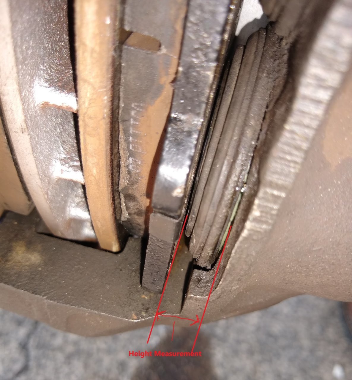

    Caliper Measurements:
    The caliper measurement was more prone to accuracy due to the geometry. I was only able to measure 1 point on the outside edge of the piston. Also, the distance of pistons might have been altered as I had to pry out the brake pad.
    Ui8UAu0591uf6CSFPh4qdGqD0MsawpdkcKf3YNjF_b7a6e8b7dffcb6df7f63689e71b30f5c0203b901.jpg
    Outside Caliper Measurements
    • Bottom Piston (closest to ground)(problem piston): 10.35 mm
    • Top Piston: 10.65 mm
    Inside Caliper Measurements
    • Bottom Piston : 8.68 mm
    • Top Piston: 8.80 mm
    Interestingly, again, on the outside caliper where the problem piston is at, there is not much deviation between the top and bottom piston. They both hover around 10mm. The inside caliper follows the same pattern.
    However, when comparing outside and inside calipers, the outside piston set seems to have increased distance vs. the inside (close to 2 mm). Not sure if this is normal or if both outside and inside calipers are supposed to be even.
    Also, these measurements are on a cold brake system. Measurements may differ when under heated temps.
    Rotor Measurements:
    Since I didn’t have a dial gauge, I was only able to measure where the X’s are at in the pic below:
    Average rotor thickness of those 6 "X" points: 22.01 mm

    A busted boot may eventually lead to a piston seizing. This may be the case already judging by the 2mm difference between the outside piston set and the inside piston set. I have had this problem for 3 years. But, I would guess since there is no brake fluid leakage history, the boot is still holding on.
    More supporting evidence of the piston set seizing is the brake pad thickness. The pads wore down at consistent rates; not just the problem piston affecting one side of the outside pad. The outside pad edge is chipped right at the problem piston as well. The rotor is also consistent at all points; nominal thickness according to Toyota specs.
    The major limitations of this test is the fact that I only was able to inspect and measure on the driver’s side tire. This could only be 1 of many probs that I have not documented yet.

    That chunking is definitely suspect... are they aftermarket? I've only ever seen that kinda damage on cheaper aftermarket ones.
    When I rebuilt a set of used calipers the kit did not come with a new boot coming the piston, only the internal o rings... I also used an aftermarket kit from centric I believe.
    My issue was steering related and not brake related so I don't know how effective it was, and I never took those kind of detailed measurements. I can tell you that at least they don't leak :thumbsup:
