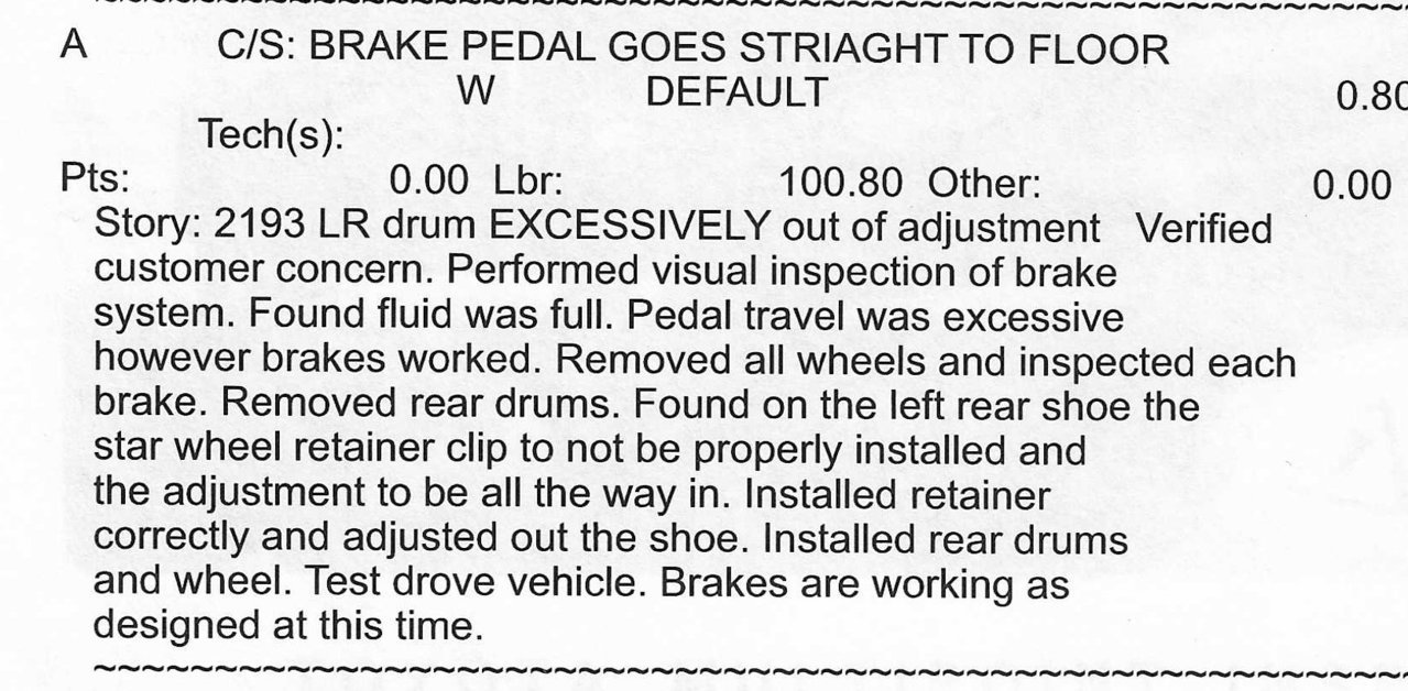

  14. Oct 4, 2021 at 12:10 PM
    downtown0309
    downtown0309 [OP] Well-Known Member
    Jul 28, 2021
    #372464
    89
    2021 SR5 4wd DC
    Went to the dealer and got the issue fixed. I don't work on drum brakes so I fully didn't understand the issue but I'll post a pic of the receipt. They basically said that a retainer clip was installed incorrectly on my left rear drum brake. He said it would have happened at the factory. The brakes work excellent now.

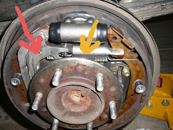

  15. Oct 4, 2021 at 12:22 PM
    Speedfreak
    Speedfreak Member in poor standing
    Sep 22, 2017
    #230756
    4,912
    Dave
    Canada Eh!
    2017 Tacoma TRD Sport DCSB 6MT, Blazing Blue Pearl
    Manual Mall Crawler
    The part with the red arrow was not installed correctly and the part with the yellow arrow was turned all the way in, leaving excessive travel in the assembly causing the pedal to drop to the floor.20211004_122009.jpg
