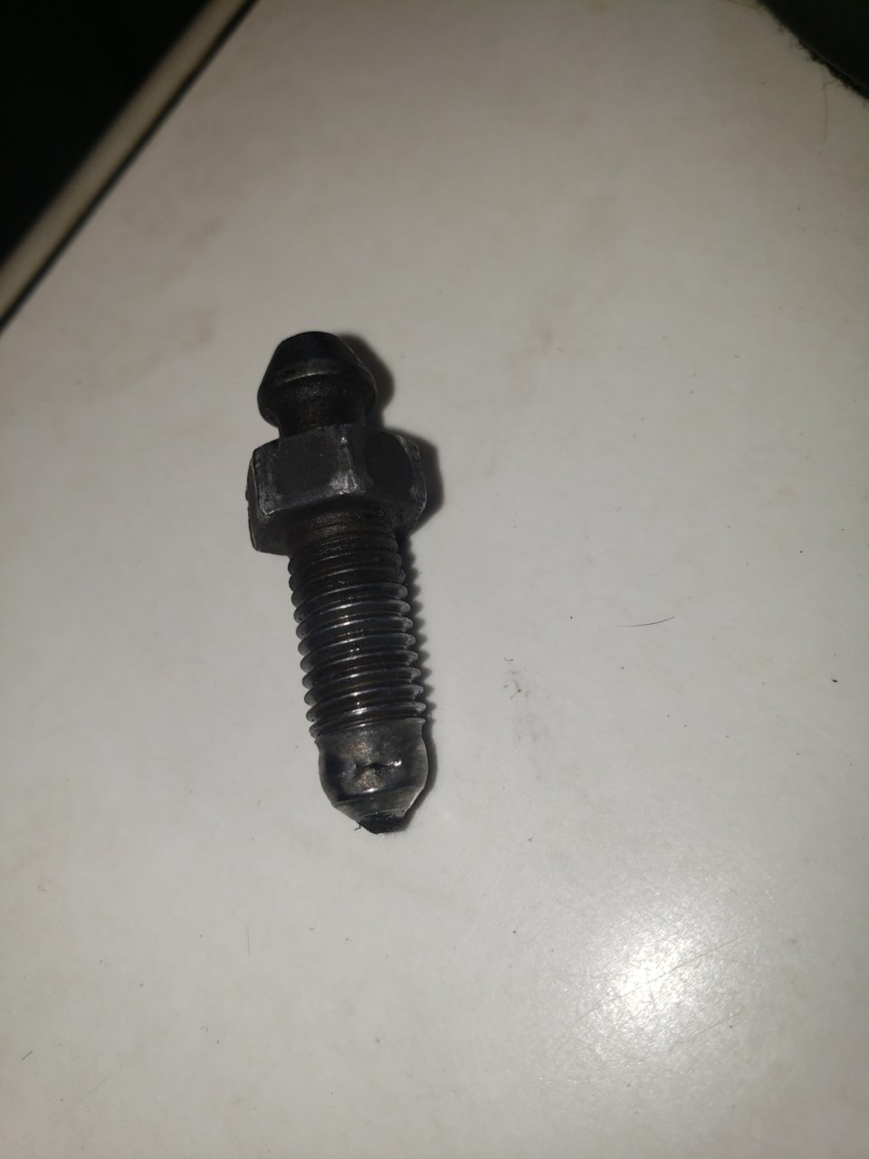

    I ordered a new booster, should be here Tuesday. I was thinking.. would restricted bleeder valves cause this soft pedal? While inspecting my calipers, I noticed my front two bleeder valves look really weird. They looked crimped where the hole is and its the tiniest of hole. I'mable to blow through it but not good. Maybe its not enough flow to bleed the air out the calipers. Would y'all suggest replacing them and seeing if that's the issue? I can get two bleeders from Autozone for $5. I'll pull them out and post a pic here shortly. The rears look normal.

    mmm well the bleeder for sure shouldn't be crimped.. but they do have a barb to connect a hose to them. if they're damaged just replace them.

    Both the fronts look like this. Probably, should go ahead and replace them, huh? Maybe the calipers are having a hard time bleeding.

    I don't think those are an issue in comparison to the brake booster being full of fluid...

    Andy, it wasn't full of fluid, but it did have some down inside the very bottom, maybe a centimeter. Hopefully, when I put the new one on it fixes the issue. I'll probably go ahead and replace the two bleeders as well since they look horrible. Keep your fingers crossed for me guys.
