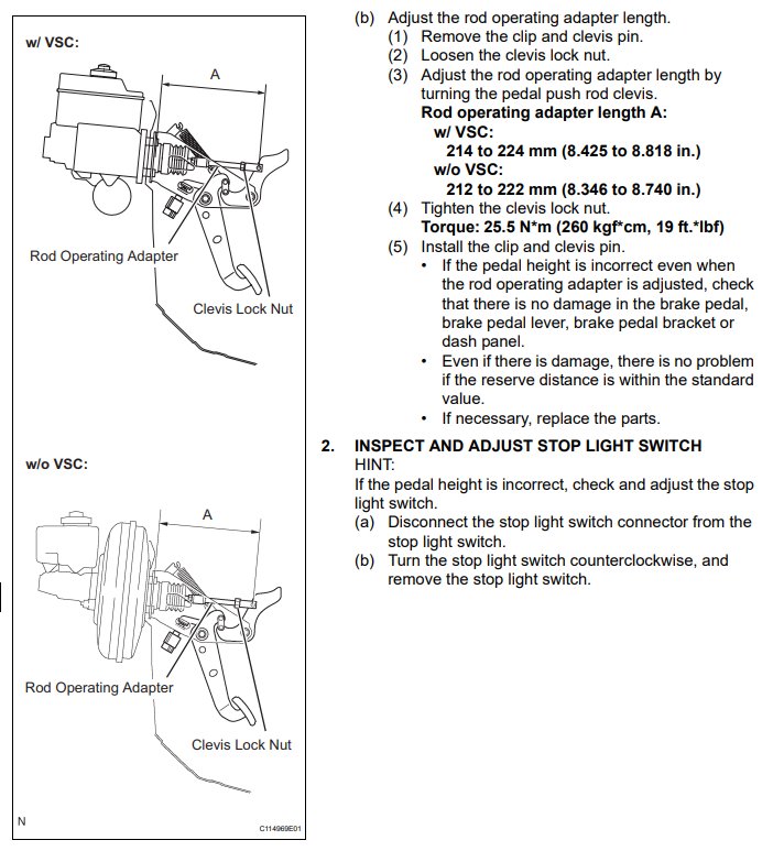

    I have a 2013 Tacoma and the front brakes have been completely replaced and the rear drums and shoes are in good shape and have been adjusted. The problem is the height of the brake pedal. As best I can determine the pedal should be about 6 1/2" above the floor. It is only about 4" above the floor and is about 2" lower than the clutch pedal (manual transmission). Everything seems to stop but the pedal is almost to the floor before the brakes engage. I have looked and the information seems to indicate that I should not be messing with the actuating rod. How do I get more pedal. I am not sure that I could stop in a panic situation. The pedal is almost on the floor.

    OK Thank you. I had seen that before and was not sure what they meant about push rod and adjusting rod. I crawled back under the dash and looked again and decided that it was going to require someone much younger and more agile than I am to do that. Hopefully it is not the master cylinder but that is a possibility because this has happened recently and rather gradually. It is more than a turn or two on the adjusting rod.
