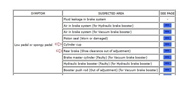

    Did they adjust the booster push rod when they replaced the booster or master cylinder?

    Assuming they did, tearing into the rear brakes is probably next.
