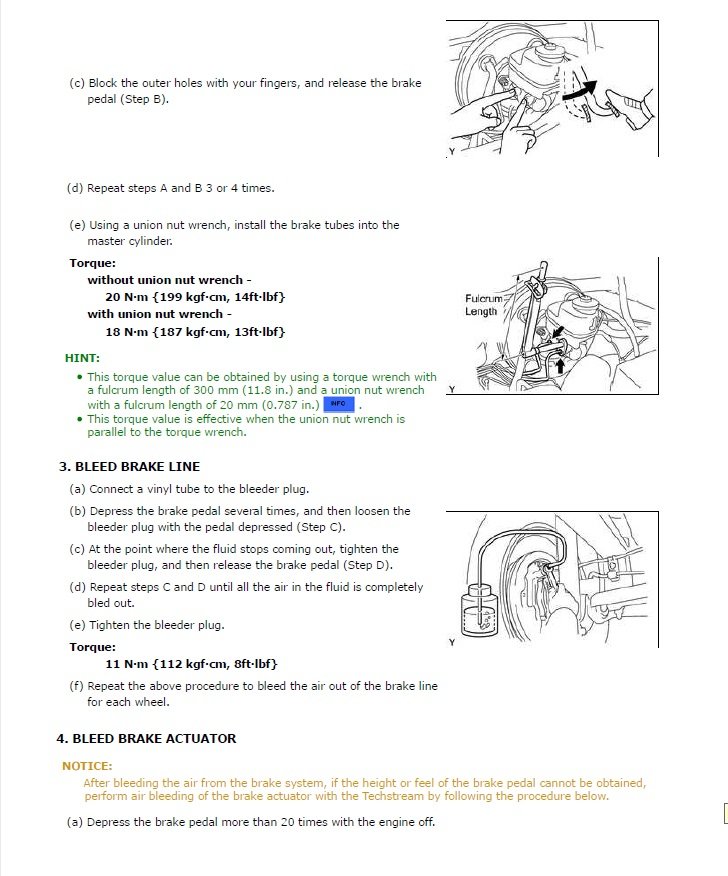

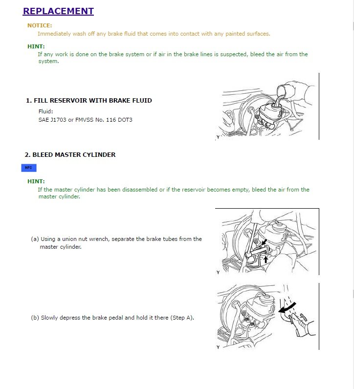

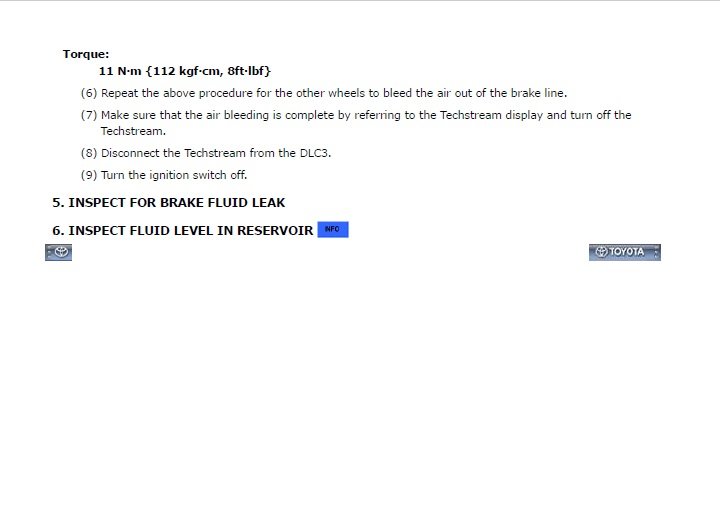

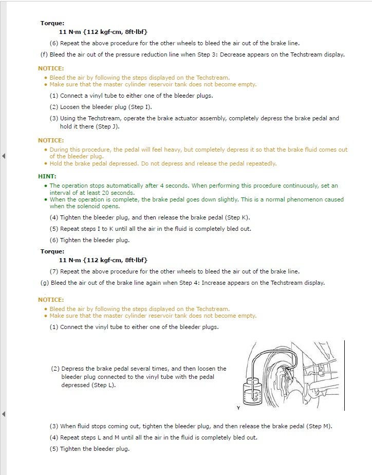

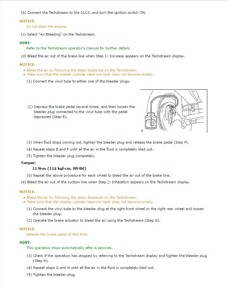

    They're using Techstream to bleed the actuator?

    Good question - they didn't mention it. I will ask next time I talk to them. Thanks

    ask them if they used the BG bleeding machine its the best one, if they did use it , it should be listed on the invoice as brakes bled using BG machine, not all dealers have this machine, but it pressurizes the Master cylinder and sucks the fluid out of the bleeder screws leaving no air in the system

    I would hope they are able to bleed the brakes and abs module correctly, that would absolutely amaze/dumbfound me if that was the problem. It is not rocket science by any means.
