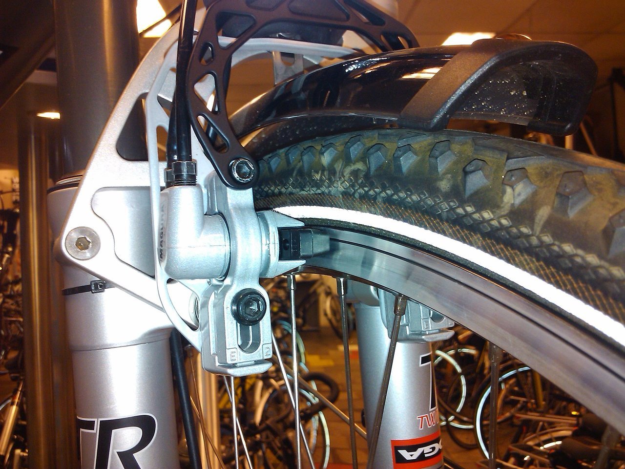

    you're right! they were normal hydraulic non-disc brakes like the ones belowMagura_hydraulic_rim_brake.jpg

    yeah those magura's go back to mid 80's prototypes with 1990-ish as the first production brakes (i think).
