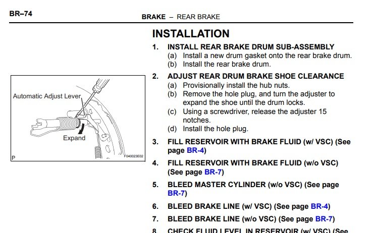

    I replaced the drums and shoes and bled the brakes and now the pedal feels reallly soft and my parking brake is completely useless. I had a helper for the bleeding part and didn’t have the key in the ignition while I was doing it. I bled all 4 wheels in the correct order. The brake pedal feels a little better when I press it 2 or 3 times while stopping. Do you think I still have air in the system? Or did I not adjust the shoes tight enough? I know the parking brake needs adjustment but I was surprised how loose it is now, I assumed it would be tighter with new shoes.

    Sounds like your didn’t adjust the rear shoes correctly.

    Probably not adjusted tight enough, did the parking brake work before?

  15. Jun 13, 2023 at 7:17 AM

    No, I kept it full. Just went and readjusted it all, I'm pretty sure it was just too loose because my drums both came off easily. Haven't driven yet but hopefully it works better now

    Best way to adjust shoes is through the backing plate with the wheel on
