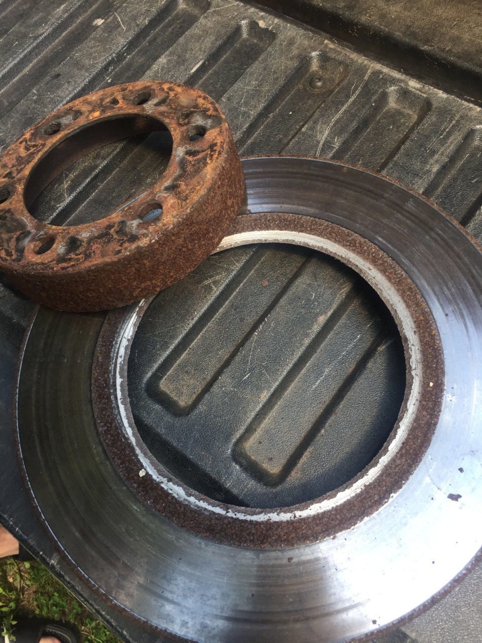

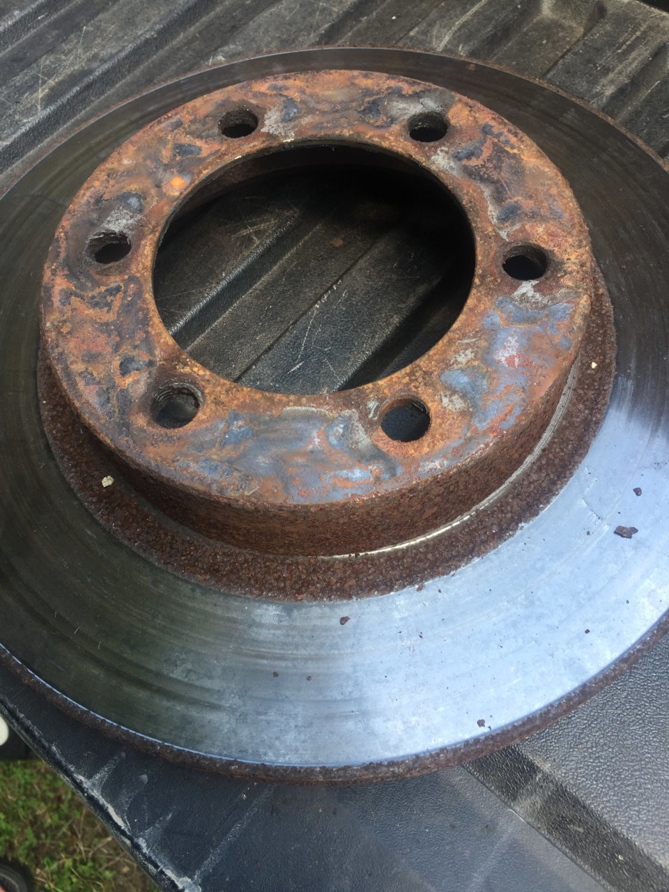

    Heard and felt something on the front left when I put on the brake - turned out the wheel hub had separated from the rotor disc - scary. Anyone else have that happen ? Be careful when U R buying rotors.

    How bad were they rusted?

    Just looked at the pictures - rust. I don't know how to post pics.

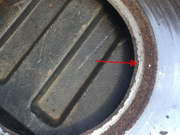

    Looks like rust has been eating away at the shoulder joint for a while:

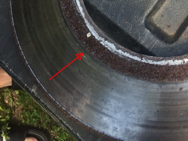

    Anyway, the rotor was worn well past its replacement thickness, as evidenced by the large step at the edge of the swept area:

    Interesting - guess I should do rotors when I do pads - there was plenty of meat on the pads. How did you do the arrow ? Thanks for the reply.

    ^With OEM pads and OEM rotors, usually the pads wear out well before the rotor does. As a result, the service manual is quite restrictive in allowable rotor wear. New rotor thickness is 28mm, while the minimum serviceable thickness is 26mm - so only 1mm of wear per side.
    The image cropping and arrows are done with an external program, IrfanView in my case.

    ^You'll need a micrometer that can get around the wear ridge on the outer rim of the rotor, something like this: [​IMG]
