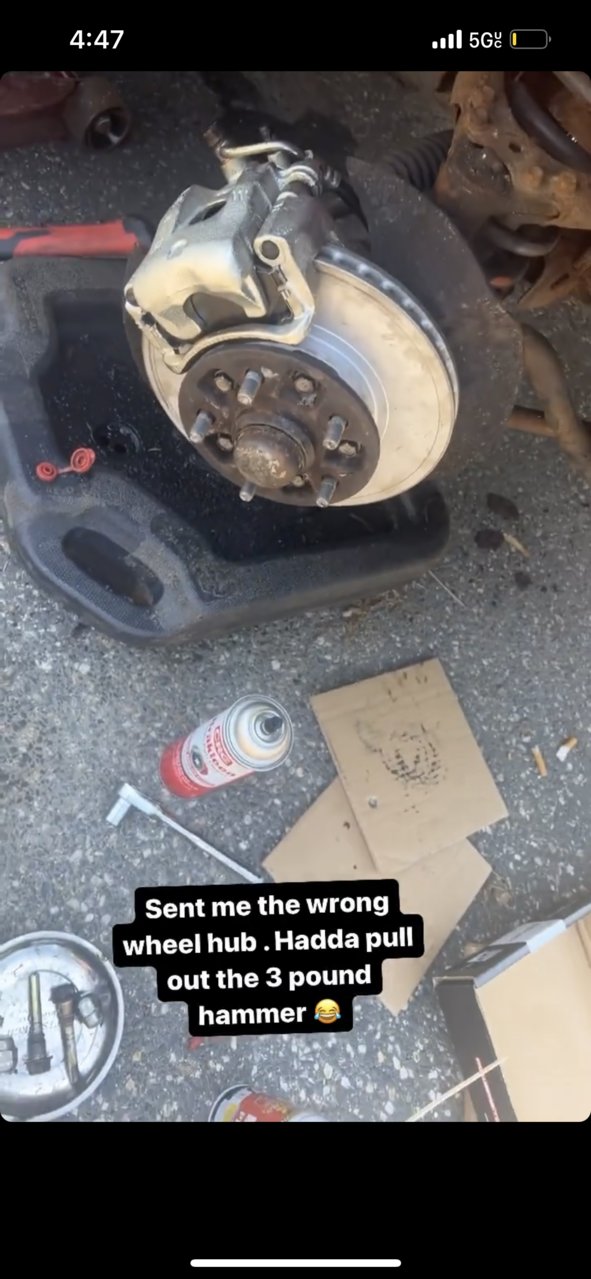

    Well everyone the job is done and I wish I used a bigger hammer earlier . I ordered new wheel hubs and they sent me the wrong ones . I can’t even find them online so I took a 2/12 pound hammer and got to smacking and broke it right off

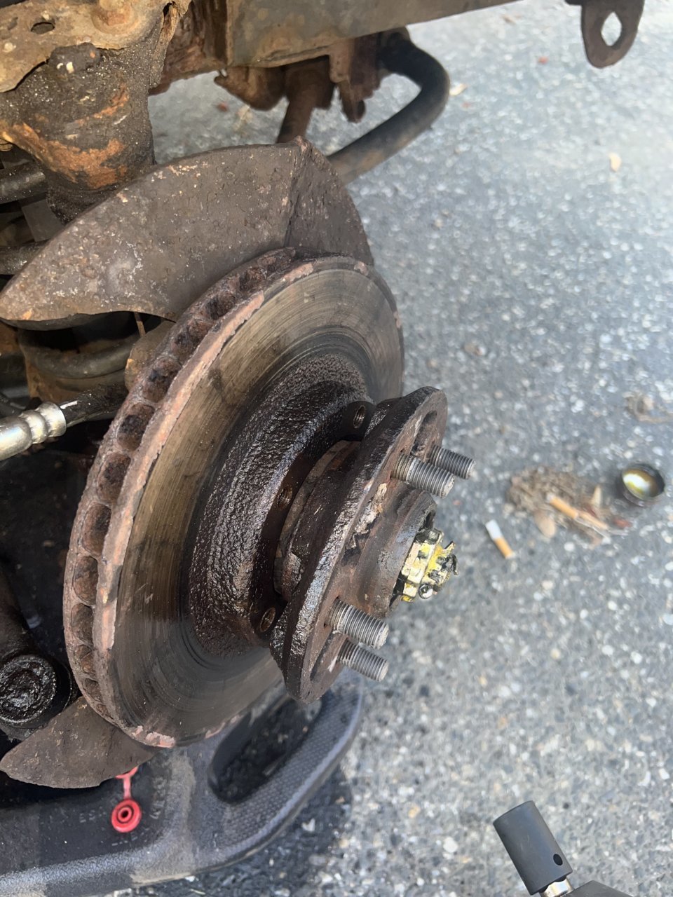

    There we go

    With just my luck I broke a stud after it all but that wasn’t too bad since everything was easy to get off . I just hope someone that got. A5 lug sees this and just get to hammering on that rotor i pb blaster tf out of it too . Then once I saw it splitting off got a pry bar and popped it off . Feels good lol . My first brake job ever and this wassnt the easiest but it’s done
