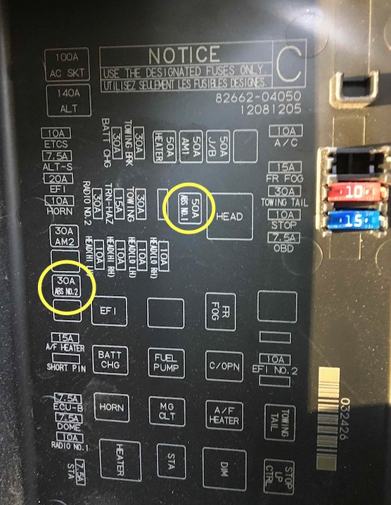

    So anyway, I discovered something. Seems the ABS Fuses aren't really Fuses, but Relays. And they can partially fail and cause problems with ABS braking. Don't know that THIS is the problem, but tomorrow I'm going to have the Relays tested. There's a lot more power required for the ABS, and if these relays don't provide adequate juice, apparently the brakes can engage. Add a slippery surface, and MAYBE that means massive shuddering?
    I haven't figured out the diff yet between ABS-1 (50 amp) and ABS-2 (30 amp), but I definitely have both as seen in pic. No doubt pulling them for the Winter is the easy solution which I did last year as well. Still i'd like to solve this mystery that so many seem to experience.

    I told you why you are having issues above, you're losing traction on one or more wheels. You have a wheel that is starting to lock up when it occurs which triggers the ABS System. That is where the pulsing brakes is coming from. I work for a worldwide manufacturer of Fuel Injectors and ABS Brake / Chassis Control Systems. I do have a small clue.
    Get better tires.
    I don't know where you got this Bogus information about fuses being relays etc. It is absolutely wrong. Both of those items you have circled are shown on the electrical prints ( I provided links) and are Fuses, Not Relays. They are large because they are used for high current as you see 50 ampere and 30 ampere.
    Fuses have two states Good = Complete circuit or Bad = Open circuit. It is a binary answer, there is no such thing as a partially blown fuse.

    Even a little bit of Oxidation on contacts can reduce the amount of voltage going thru a circuit. It doesn't have to be 'blown' to not work properly. I had a 30 amp 110 household type breaker last year in my hunting trailer that I suspected wasn't working properly. For some reason I wasn't letting ample current reach my Inverter. I can't remember the exact voltage getting thru, but it wasn't what it should have been. So I changed the breaker out and the voltage returned to normal. Those are supposed to be on/off too, but apparently that's not the whole story on how they function. Not that this direction will solve the problem, but being its generally overlooked, so definitely worth more investigation.
    I should also add for readers that my 06 is a Manual Trans not Automatic, so it lacks certain traction options. Oh yeah and there are no ABS Codes that come up.

    Does the 'relay' have two terminals, or more?

    The one I pulled had 4

    I don't remember and won't know until I pull them in town. Running around now but I suspect its the same as Replica's.

    Couldn't log in till I got home as I don't have the pw on iphone yet. As it would turn out, mine ARE Fuses not Relays and only have two pins. There are plenty of relays there in the fuse box (all the larger ones are), but both these are fuses in mine anyhow. So any failure with them would probably only be related to lack of voltage moving thru them like from oxidation at the contacts, which I'll check closer over the weekend.

    Well, I don't want to say I told you so, so I won't. :) But those two devices you had circled are the fuses in every Tacoma with ABS. If you take the time and look at the two factory schematics I linked to earlier you will see that there are no ABS Relays with the exception of the DAC and Auto LSD.
