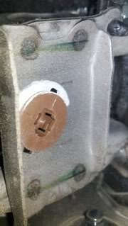

    My switch broke off, the entire housing for the plunger piece is still locked in without anyway to get traction to unscrew it... I have a new switch assembly but cannot seem to get the broken one out with so little space. Any suggestions here?

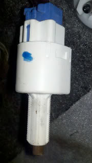

    I have fixed my switch today after a month of head scratching and not realizing my brake lights were out... Doh! The switch is extremely simple, if you use a volt meter, you should get continuity with the switch pressed in across the 2 smaller contacts on the back. Overtime, the contacts (inside the switch) will start developing carbon buildup which was the case with mine. Shot the contacts with some contact cleaner and wiped them down with a q tip. Checked continuity and it was good to go. Before I put the switch back in, I manipulated it manually to see if I was able to move the shifter to the far right from park (I rock an automatic). It took me some time to realize that when the switch is not depressed is when your brake light comes on and that you are able to shift. I kept pressing in the switch and trying to get the damn shifter to move lol. But yes, if anyone else is having an issue with their brake switch definitely try cleaning the contacts and lubing the plunger. There really is not much that I can see that requires the switch to be replaced unless you physically break it.

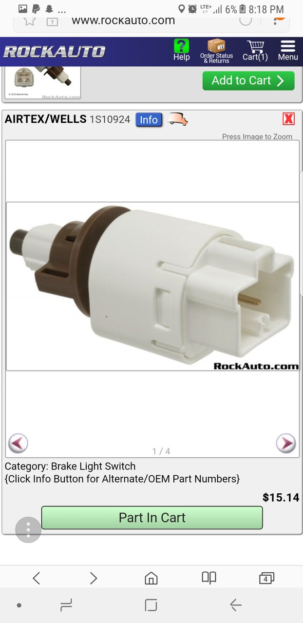

    On my 08 Tacoma 4.0L Auto, the Napa Echlin part number is SL855. This is a cross from the # given above (8434009070). It has been superseded from SL1045. I work at Napa btw.

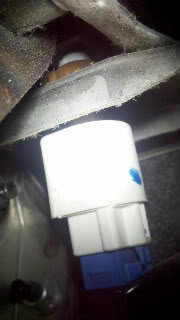

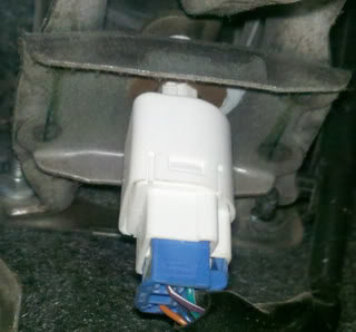

    I’ve been searching about the potential causes for the shifter not wanting to move and after reading through many of these awesomely informative threads, my first guess is this break sensor thing has been knocked out or gone bad , but looking as far up under the peddle as I can I cannot see anything resembling what I see in these pictures.
    I thiNk These pictures are zoomed in too far for my beginners eyes. having never looked under a truck’s break pedal before I don’t quite know what I’m looking at. Their seems to be a few different harness clip things around the break pedal area? But I don’t want to cause more trouble for the truck (and my husband) than what already exists .
