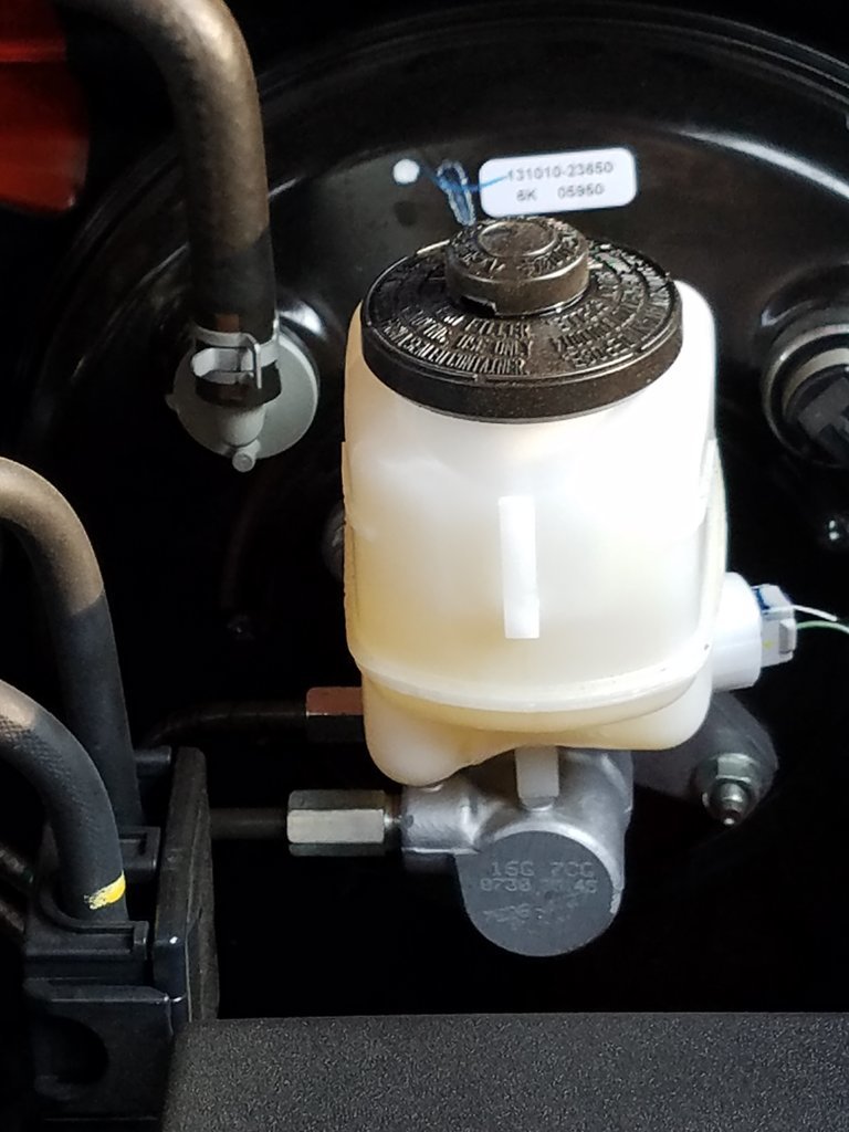

    This is old master cylinder

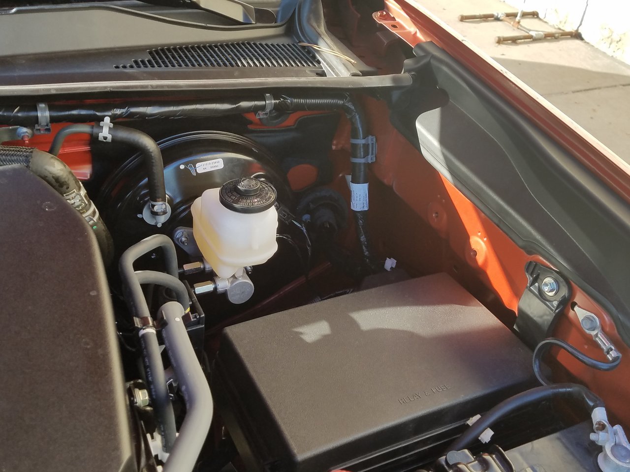

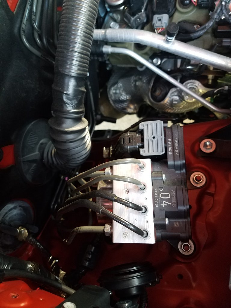

    New parts they added

    They replaced the abs module and then the master cylinder
    The system was eating brake fluid at one point.
    The picture shows the booster or vacuum pump.
