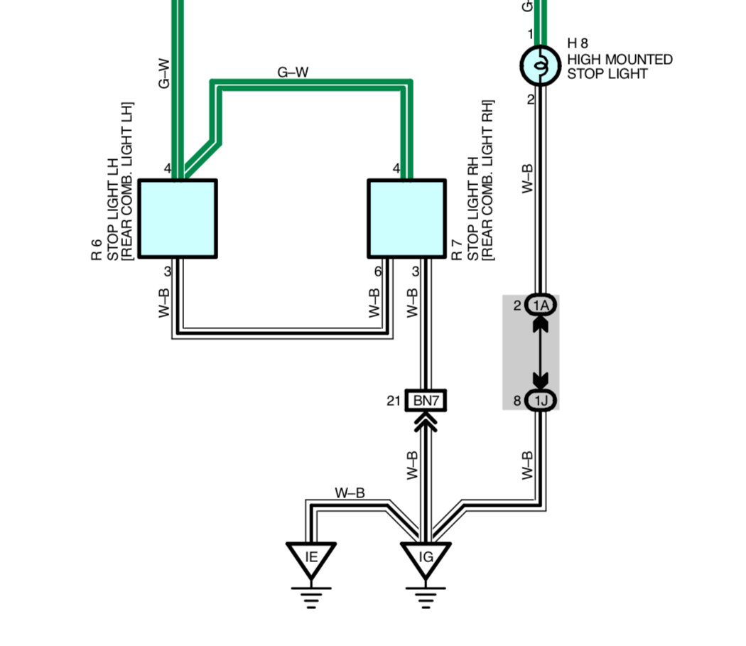

    My diagram shows the Ground for LEFT rear stop light goes THROUGH the Right stop light.
    Both lights use the SAME ground location once the leave the right taillight.
    My bet is that your problem is between the left and right taillight. (If it’s actually a ground issue)
    White/Black wire is the ground wire. Pull the left tail light and check it for ground

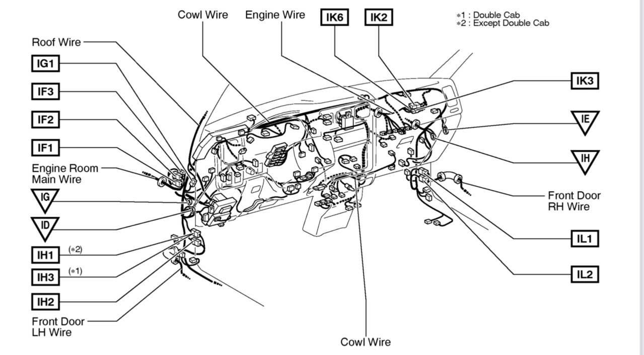

    They 2 are up in the cab.one under the hood
    on the left inner fender
    right and left cab reinforcement .
    Many circuits attach to these ground points you would have many more problems then just lights.

    It’s probably easier to show you
    You need to understand that then LEFT light Ground goes THROUGH the RIGHT light.
    Then out of the right light and to 2 (yes 2) different grounds.
    I’d start with pulling the right light and testing the ground wire between the 2 lights.
    IE and IG are the Ground locations.79EE280B-5E49-4A56-8C8F-E6DA04F8C817.jpg8A68CCC7-1C60-4962-9240-689949F70EA0.jpg

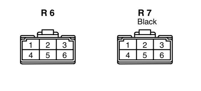

    How exactly are you testing the ground connection?
    If you want to check the Ground wire for the Left light.
    Here is how I’d do it.
    Pull both tail lights.
    The Left tail light plug is R6 pictured below.
    The Right is R7
    Test for Ground at pin #3 of the R6. Black/White wire. (Left light)
    If you have NO ground there, test for Ground at the Right light R7 pin #3.
    We’ll go from there.
