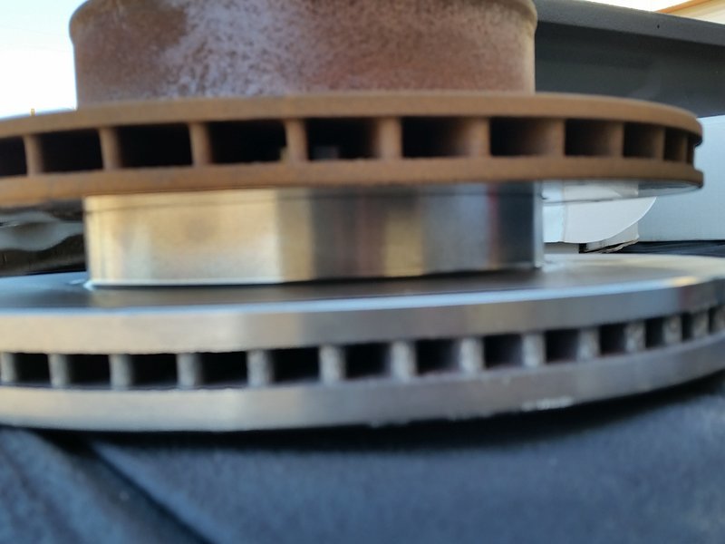

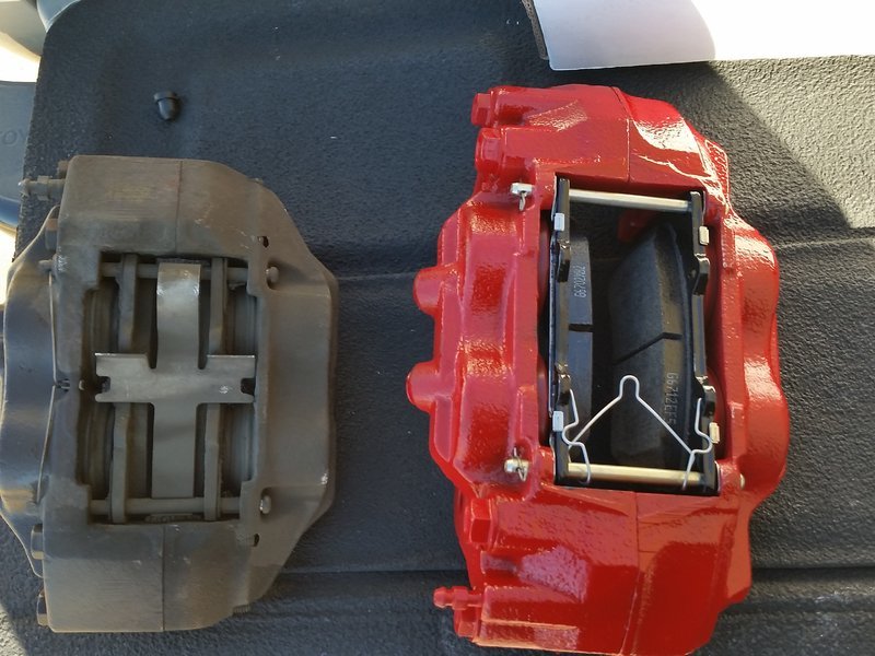

    I used 2005 tundra v8 4x4 rotor pads and calipers. There 4 pisron calipers. There huge.20161029_154846.jpg

    Holy crap those calipers are huge. Now I can see why they have so much stopping power.

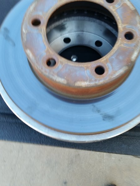

    Also bigger diameter and thicker rotors.
