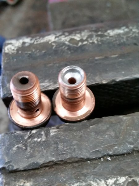

    Banjo bolt modification I did. Used a drill bit and go straight and slow. Make sure all the metal shavings are out of bolt hole before use.

    remember what size drill bit you used, and how far?

    used two drill bits. if I remember right 1/4 inch about 1/8 inch depth and a 3/8 to just taper the outer edge.
