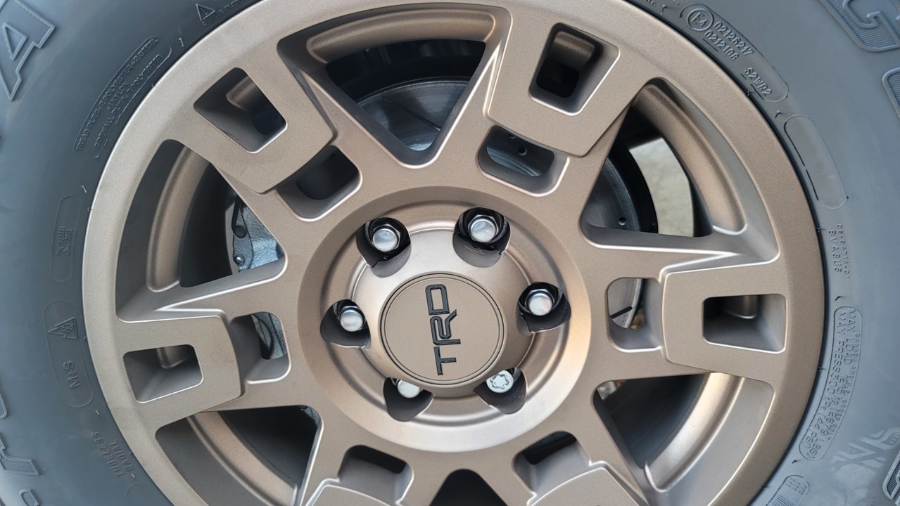

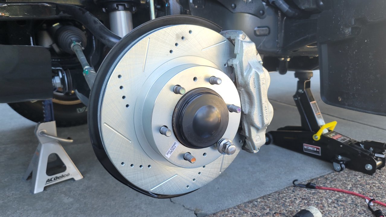

    Having had 2 3rd gens now, I was never happy with the stock braking performance. I felt the power was good, but brake lacked feel and good modulation. I don't tow, and big brake kits were a little too much $ for me.
    I did a crap ton of research as usually and went with Power stop rotors + Hawk Performance ceramic pads. Having a relatively new truck, I could have gotten away with just the hawk pads, but I rather have new rotors to mate with them. Total cost was around $250 and an hour of my time.
    After bedding in the brakes, the feel was fantastic! No noise, not too aggressive initial bite, and more braking power!
    Coming from performance cars, I've always focused on tires, suspension, and brakes. I bring that same philosophy to the Taco as well

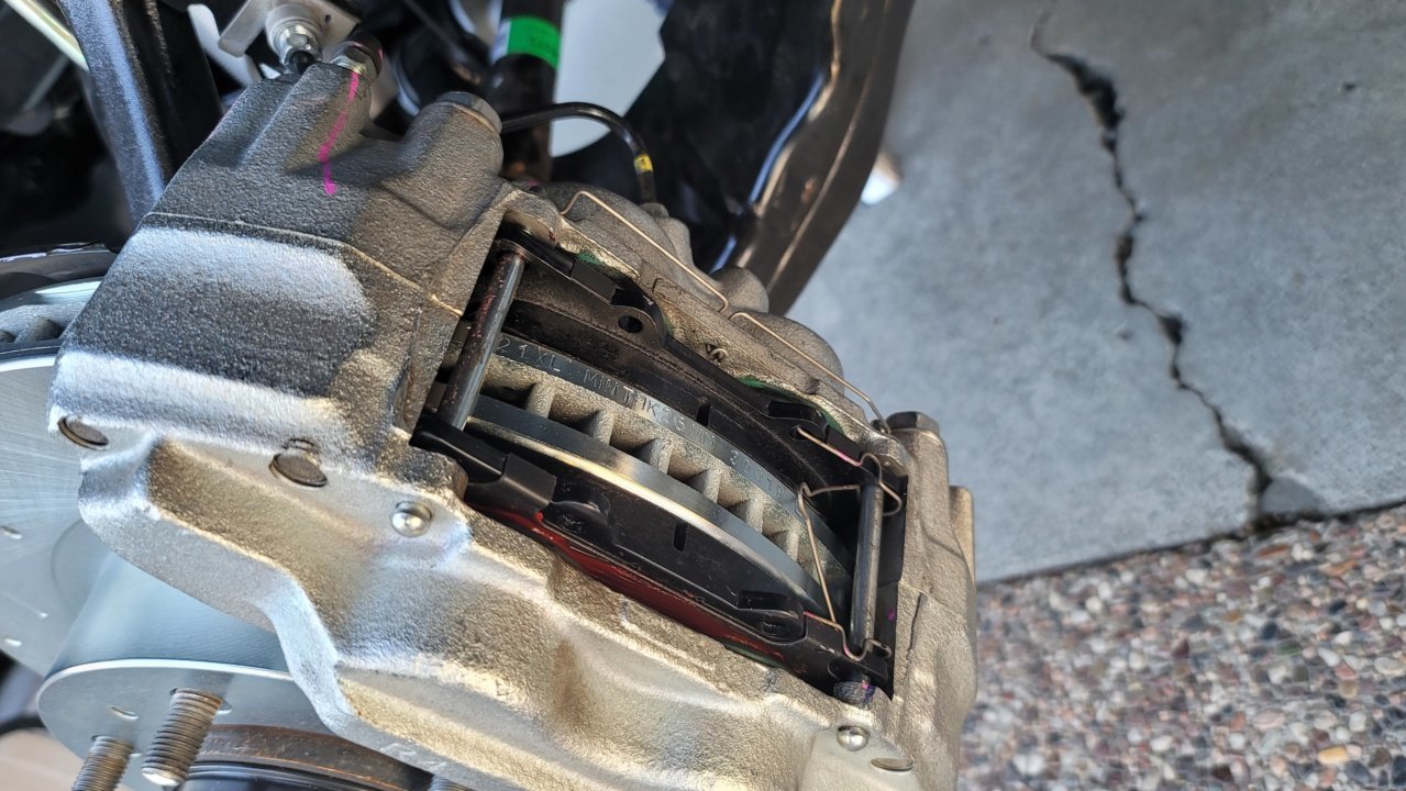

    did you replace the calipers too? they look brand new. the last 3 times I had the shop look at my brakes they said the calipers were junk. two years later the brakes feel like crap again. might have to try this setup myself
  6. Oct 1, 2022 at 8:18 AM
    stan23
    stan23 [OP] Well-Known Member
    Jun 20, 2014
    #132351
    2,393
    stan
    Santa Clara, CA
    2025 DCSB TRD Sport 4x4
    The Hawk pads, I got from tirerack, and the rotors from summit racing.
    I did not. The calipers look new because the truck is new! Picked up the truck about a month ago.
