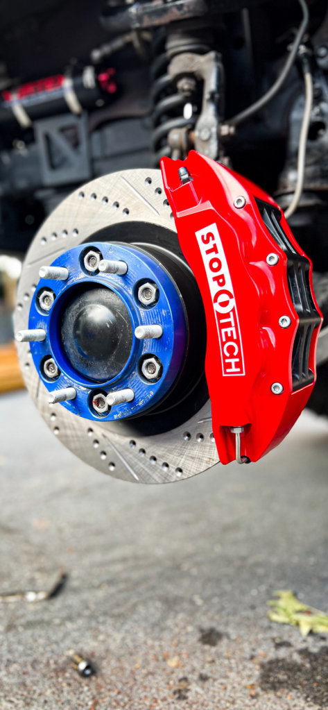

    I believe stoptech made the kits for trd. URD has them at a decent price.

    I did StopTech as well. Good upgrade.

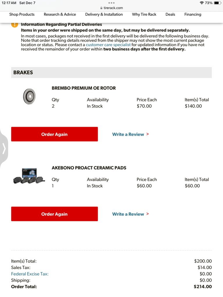

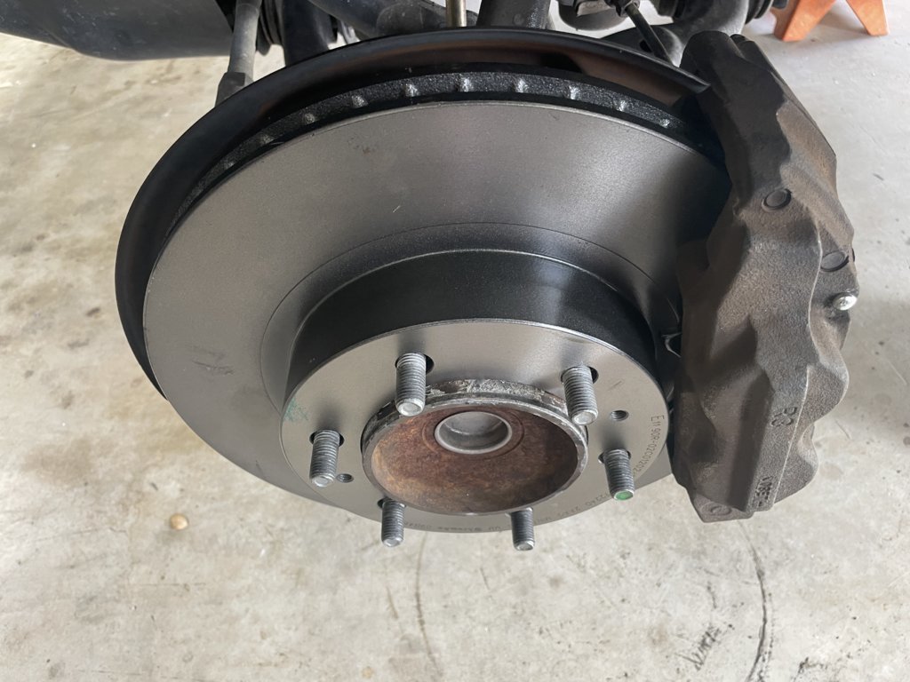

    I recently completed an upgrade of my OEM front brakes. I warped two sets of OEM rotors before making this upgrade. Haven’t had to do any hard stops while fully loaded with this setup yet, but the quality, smoothness, and stopping power is much better.
    The Truck: Stock’er ‘17 SR5 V6 2wd. I use it for my daily commute and geology consulting. All the roads are paved in South Florida, no need for 4x4 in the years i have owned it so far. 115k miles, just broke in…IMG_5527.jpg
    The brakes (front):
    Bembro high carbon performance rotors, paired with Akebono brake pads. Verdict, like butter! The best, superior to OEM.
    I bought the brake pads and rotors from Tire Rack and the brake parts kit from Rock Auto.
    So folks, if you’re looking to upgrade your stock setup and you’re running the standard tires and wheels, this is it! IMG_1563.png

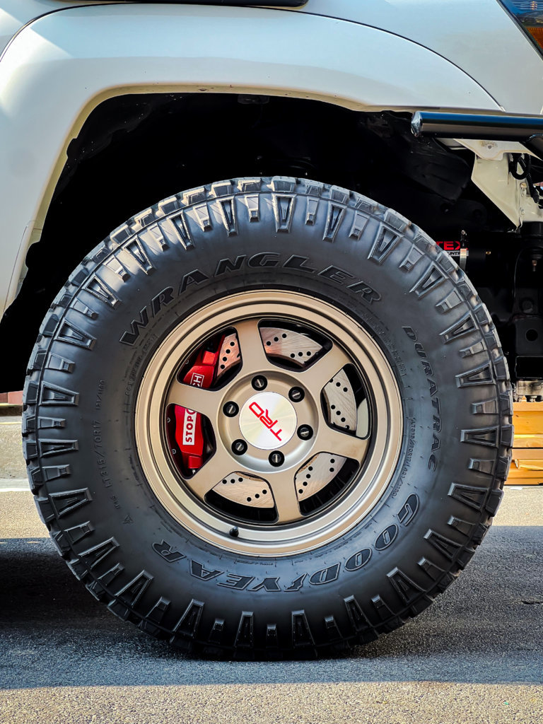

    Don’t look back and do it…worth every penny!

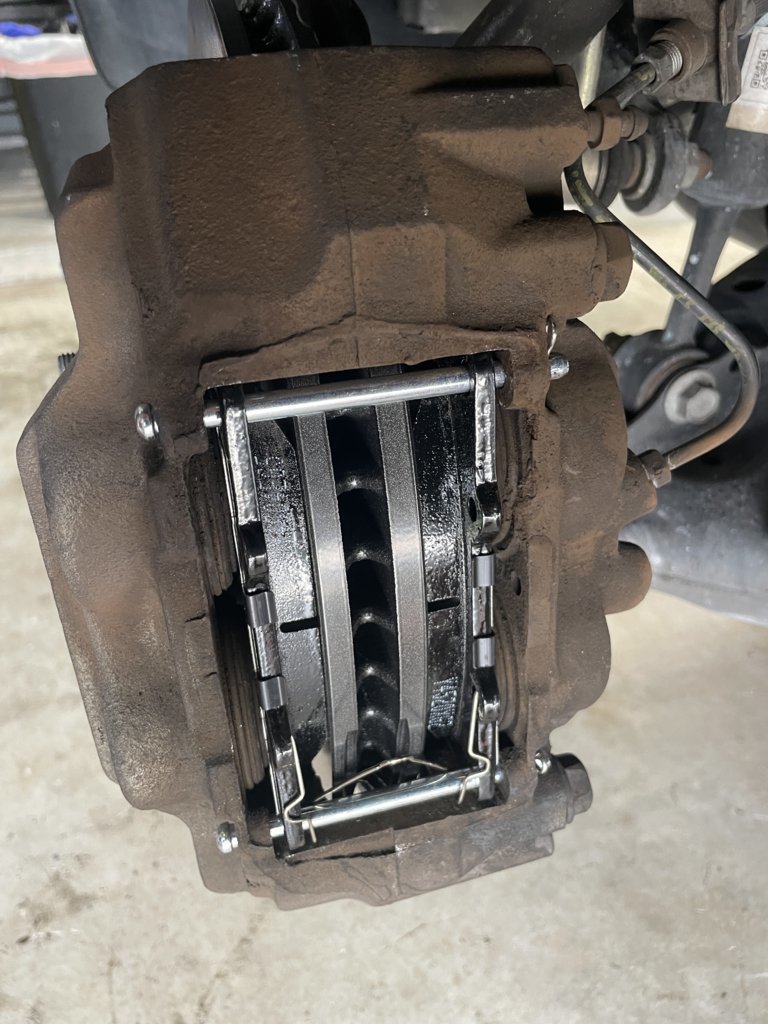

    I put together this same setup last year. I went ahead & rebuilt my calipers as well with a Toyota seal kit.

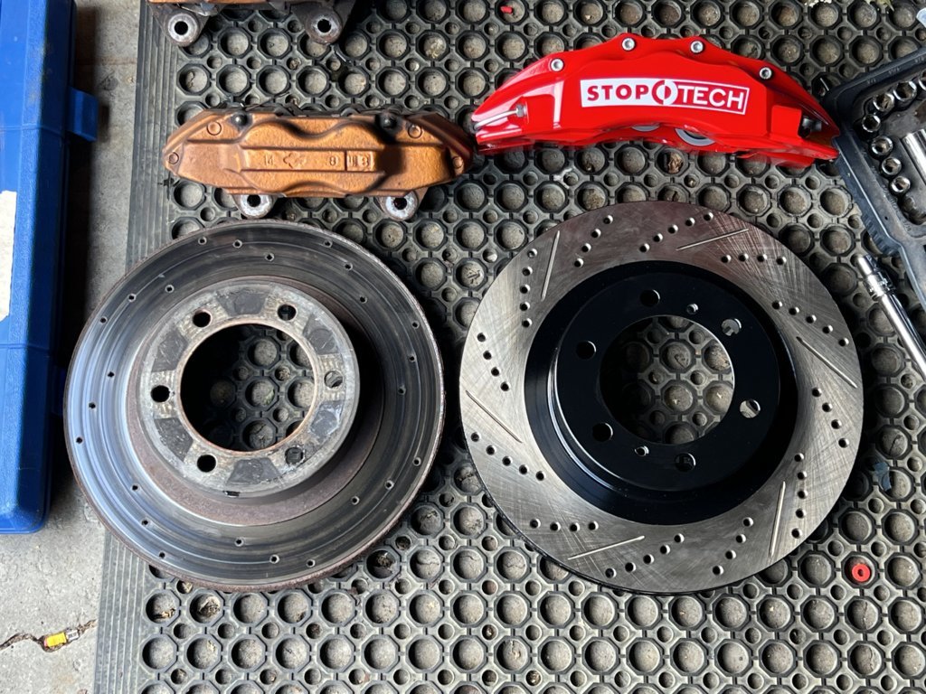

    I did the T4R front conversion, and got stop tech rotors (drilled and slotted). Then got the SoS rear break conversion. T4R was a significant upgrade. No fade in the mountains and when it’s wet. The rear conversion was an another noticeable increase although a decent cost. The front calipers I got from the dealer at a decent discount.
