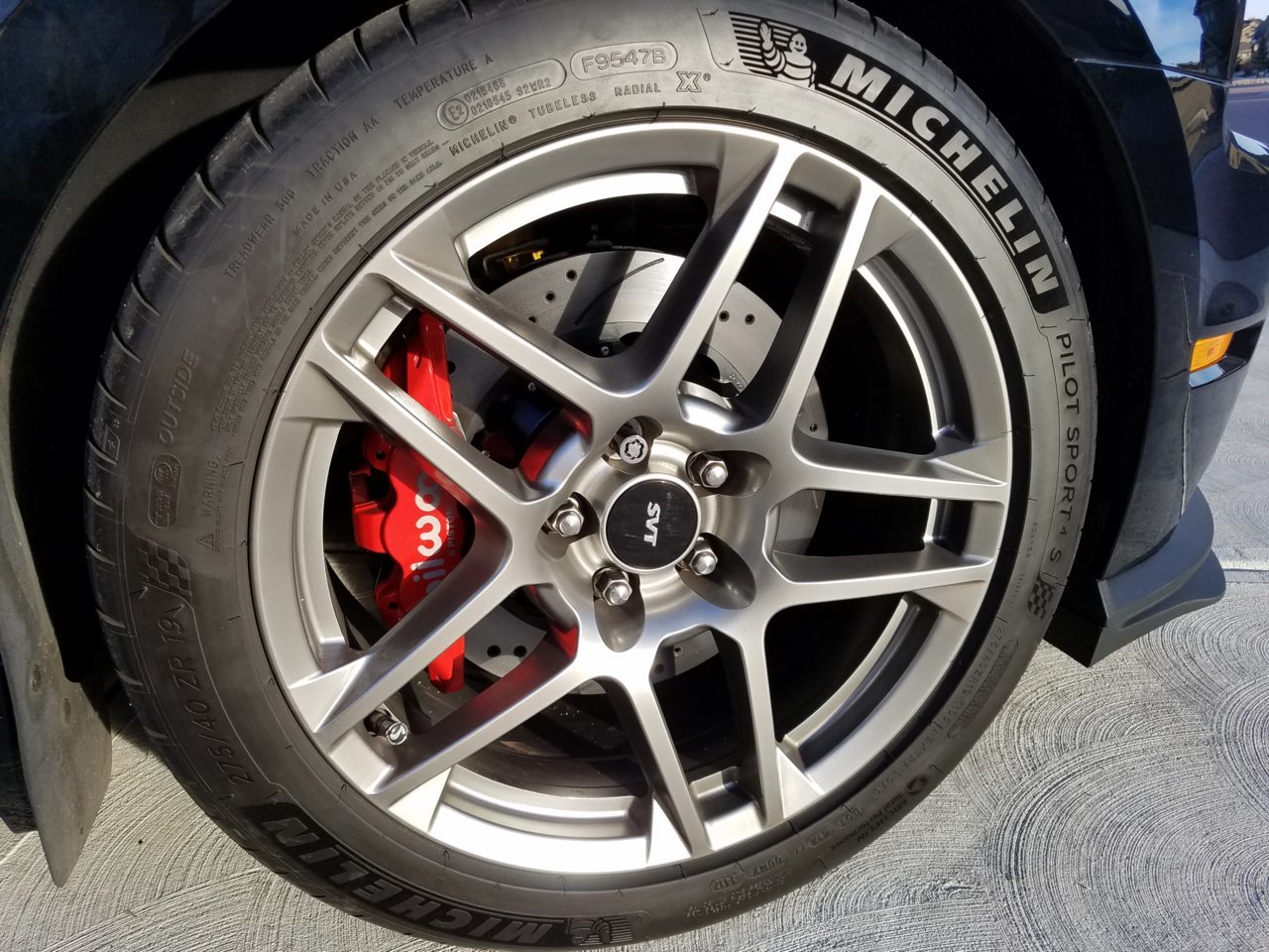

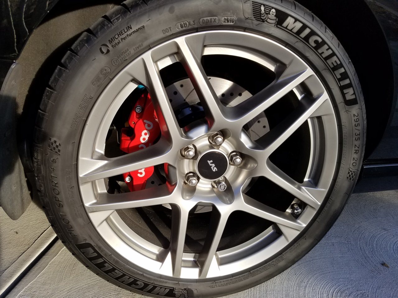

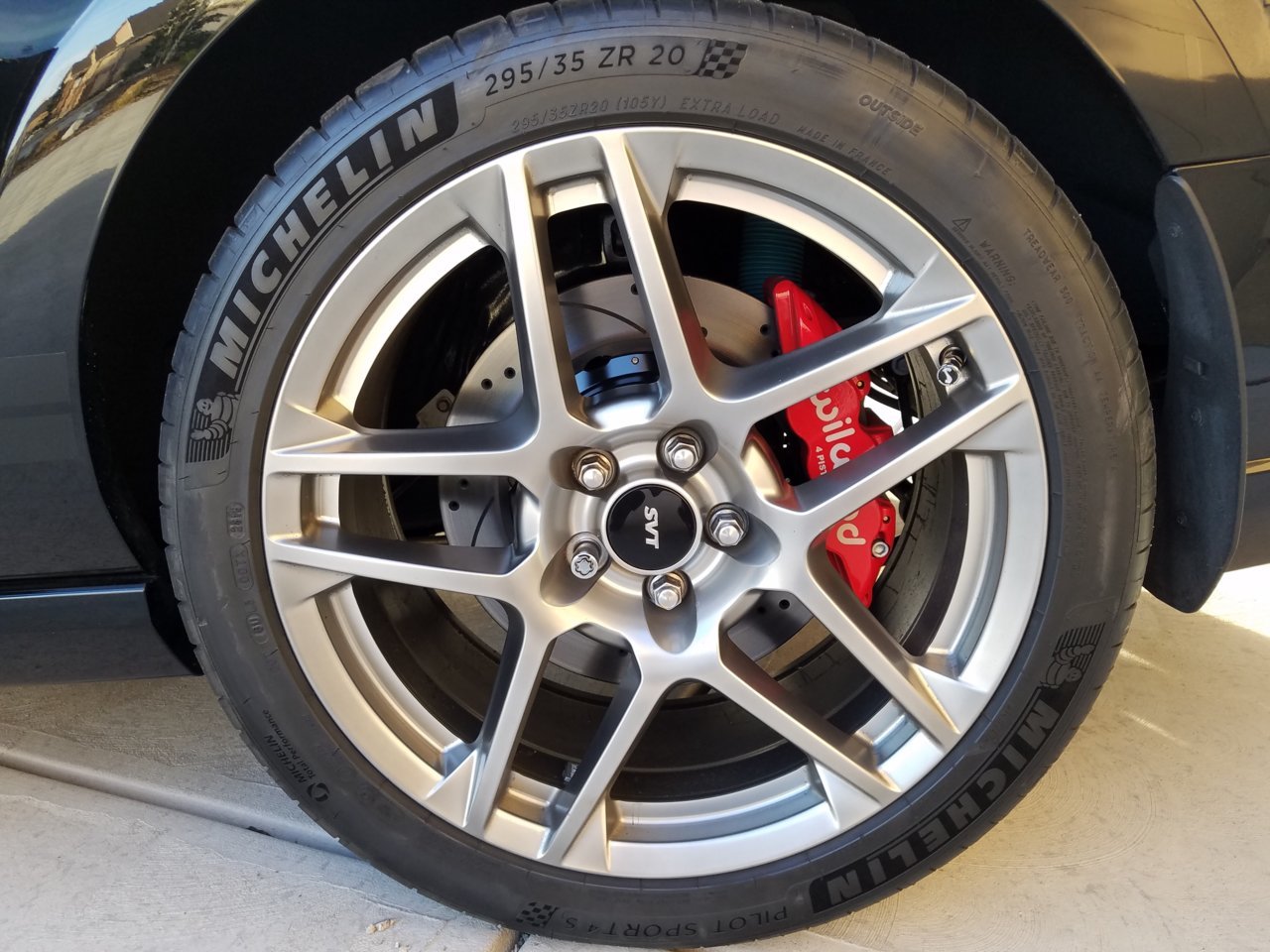

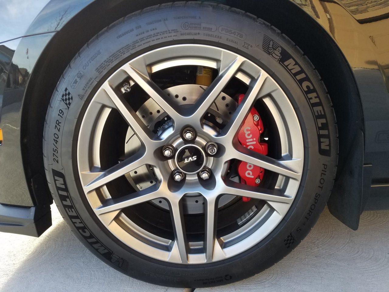

    Pretty good auto brakes too. Their AERO6 & AERO4 Big Brake Kits on my GT500...
