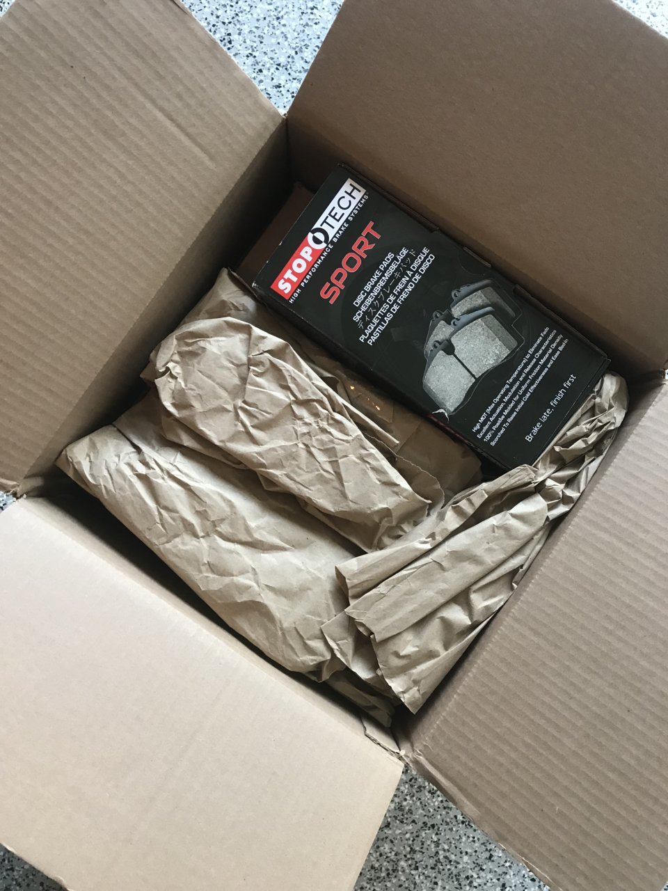

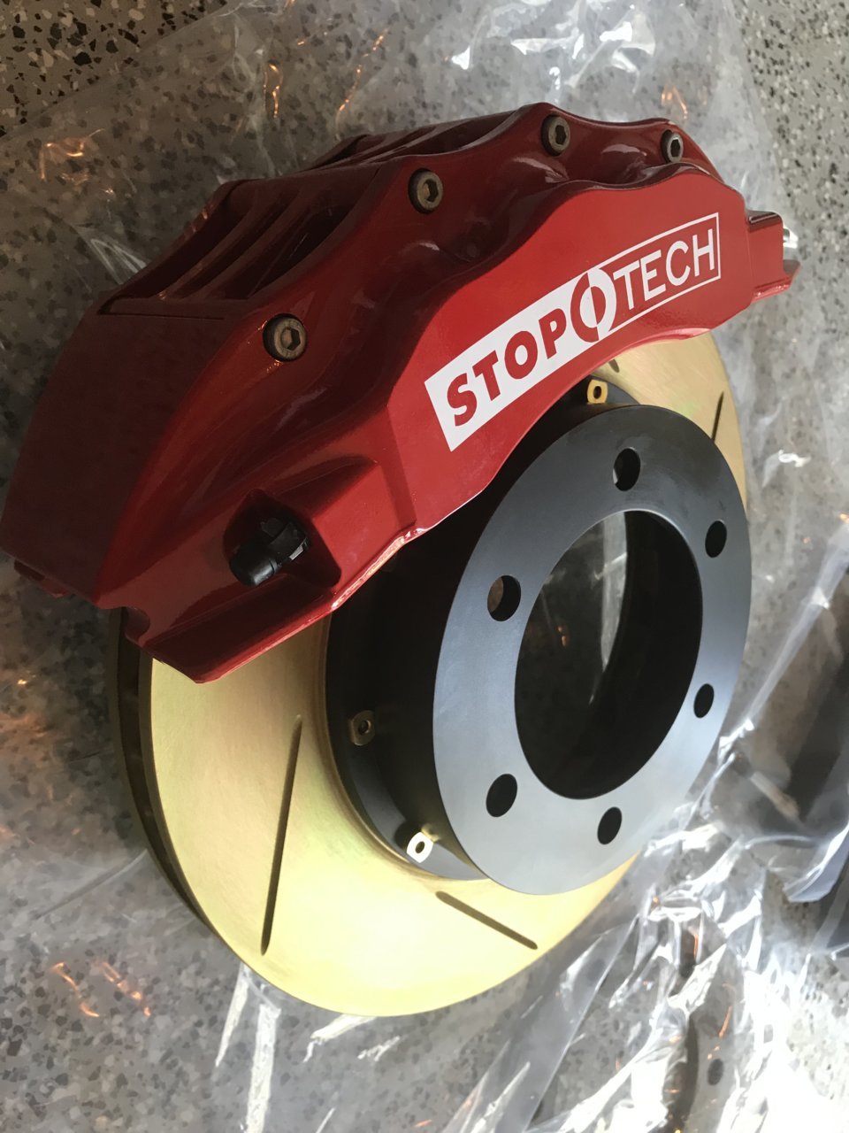

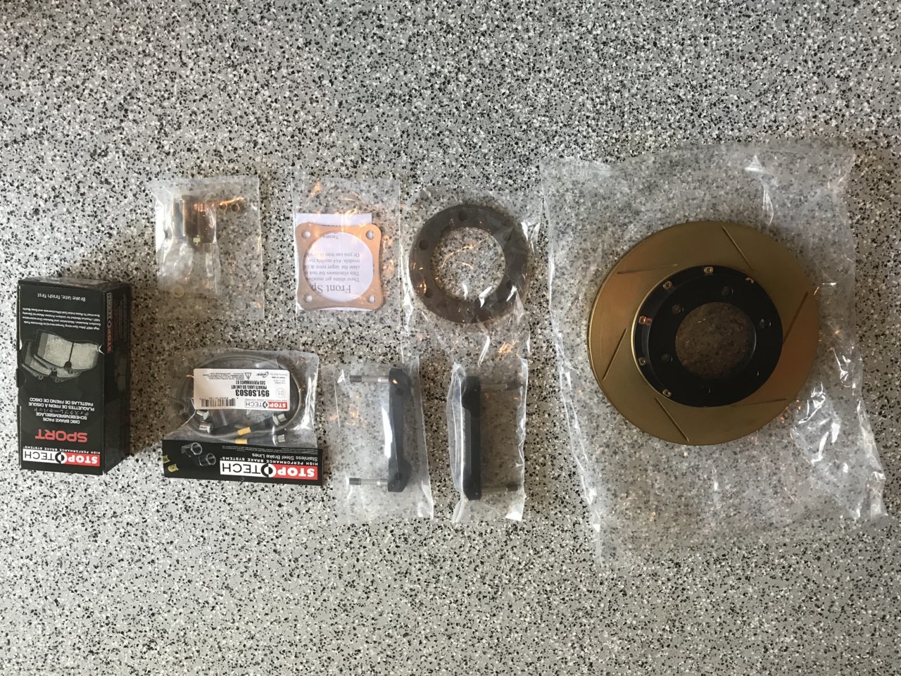

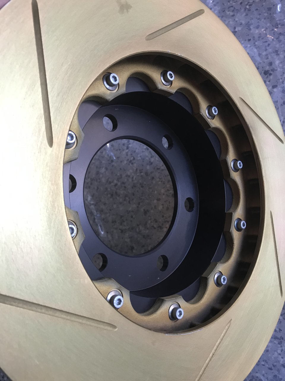

    Ho ho ho merry. Christmas! Unboxing my pressious :bananadance:238A518B-9184-4D57-94AB-43F2E7DAFB3A.jpg337D005F-7C6C-4A03-9EAA-620E88BCC9BB.jpg5EFDF941-8BA7-4E35-A4FF-D2D0C694FF93.jpg791F3B81-6B53-43DF-AED2-9BD5136B5192.jpg

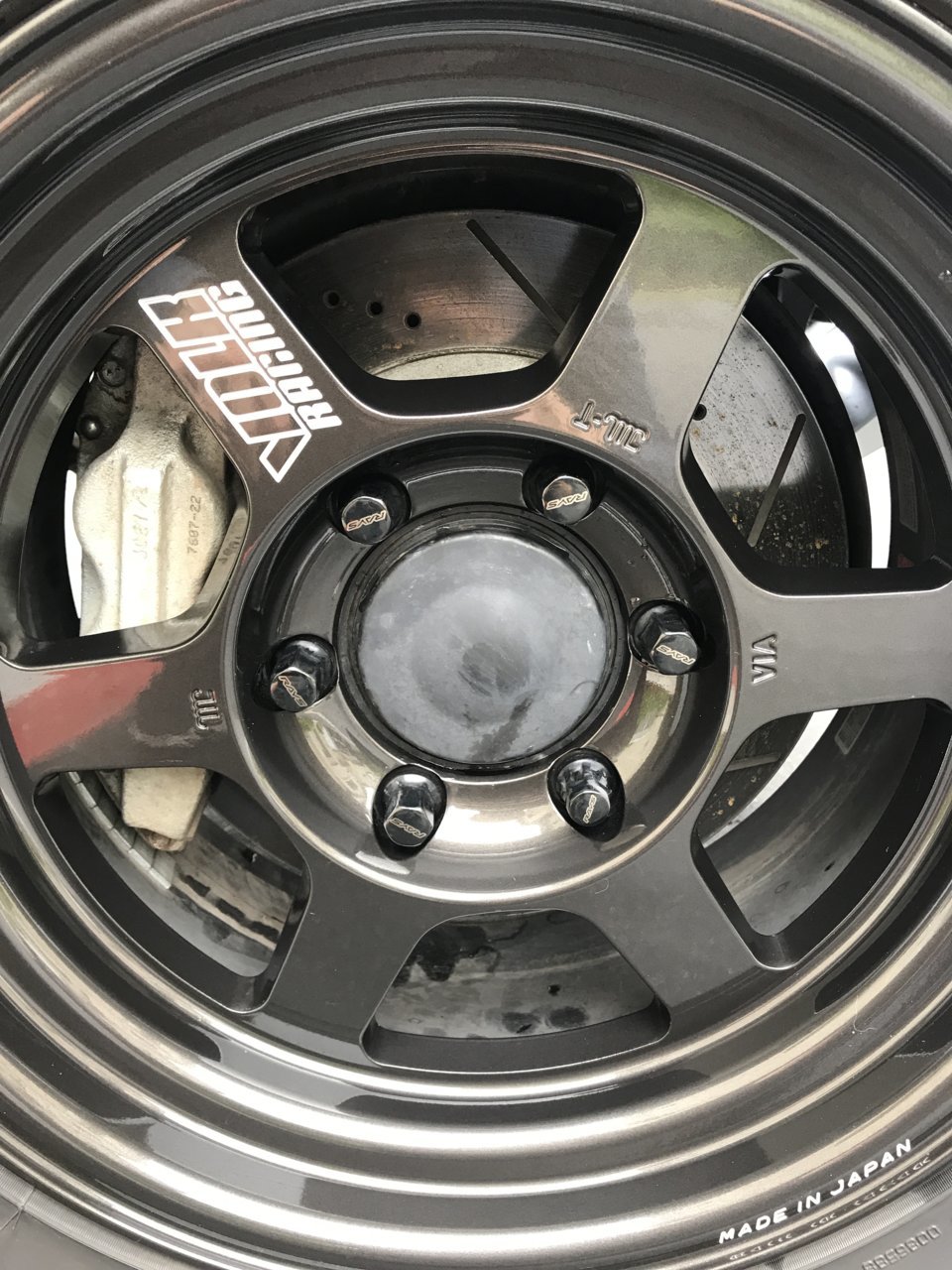

    Not installed yet. I’ve been talking to the sos performance guy for a while printed out the template and they should clear the volk 16” rim fingers crossed. He added some shims just in case but I’m not a huge fan of that idea. Rays don’t use the et lugs for some reason so there isn’t that much stud to grab onto to begin with. I’ve not installed yet but they claim an impressive 50% improvement over stock.

    What wheels are these going behind? If these fit behind my Stealth's I am game...

    As soon as these get installed I’ll report the outcome guys. I’m running volk. This is as it sits right now wirh oem calipers and recently upgraded rotors. I believe sos performance has a template you can print out and measure your wheel to see if it fits.

    The calipers are certainly a lot LONGER but may still be ok height and width wise.
    Either she's gonna be fuckin tight buy!
