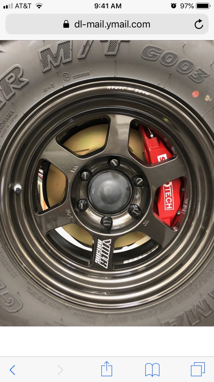

    What rims are these going with? Thinking about picking them up. I got 4.3 bs with 1.25 spacers going on
  9. Jun 20, 2019 at 8:36 AM
    #309
    alexplb
    alexplb Well-Known Member
    Jan 23, 2019
    #280401
    978
    Mine are Volk Te37x 0 off set 16”

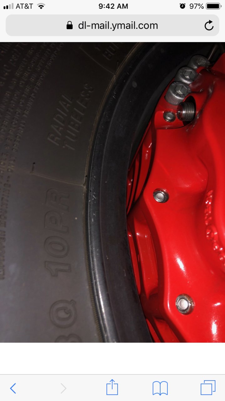

    Talking about a tight fit .... now I need to figure out what to do with wheel weights /:

    Wow, that is tight! Don’t the instructions specify a minimum clearance from the wheel to the caliper? Double check the minimum clearance spec.
  18. Jun 27, 2019 at 10:52 AM
    #318
    alexplb
    Jan 23, 2019
    #280401
    978
    I know was thinking the same thing I guess it doesn’t have specific requirements for the distance there just the distance between the face of the wheel and caliper. But I’m not sure how comfortable I am with 3-5 mm there left. I can’t run the glue on weights :/

    I just got new tires on and they didnt use glue on. they used some that clip on to the inner edge of the wheel
  20. Jun 27, 2019 at 10:58 AM
    #320
    alexplb
    Jan 23, 2019
    #280401
    978
    Yeah it depends on the balance shop. In general I hear it’s best to have them in the middle of the wheel rather than on the edge somehow it’s a better way of balancing (not sure if I buy that ) but one on the edge would be also more exposed to getting knocked off while off road /: thinking maybe I need to sell those and move to a 17” wheel altogether
