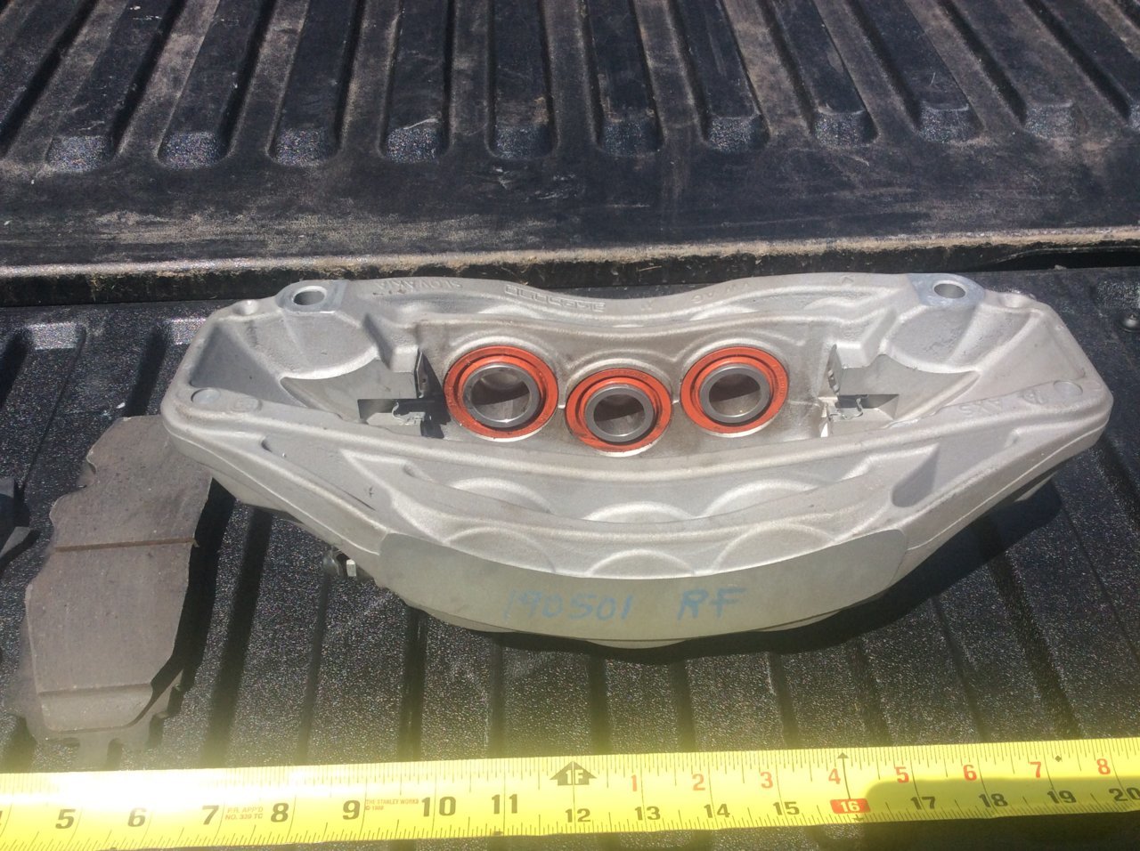

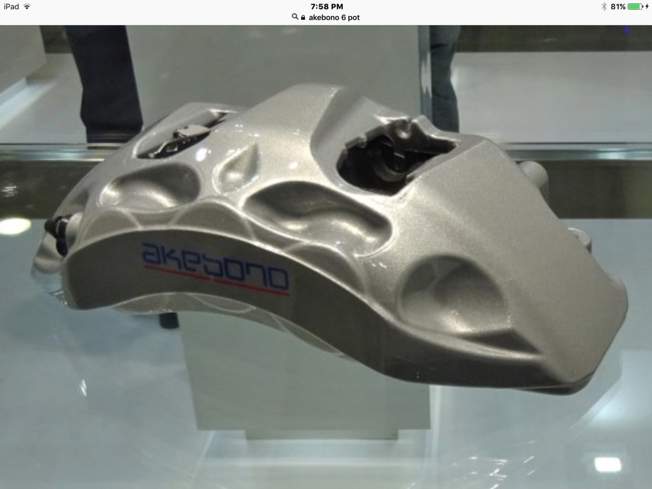

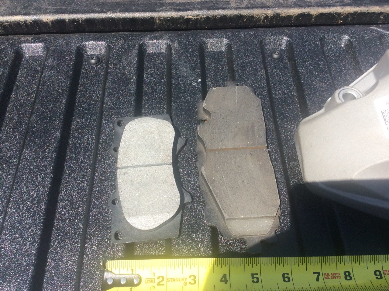

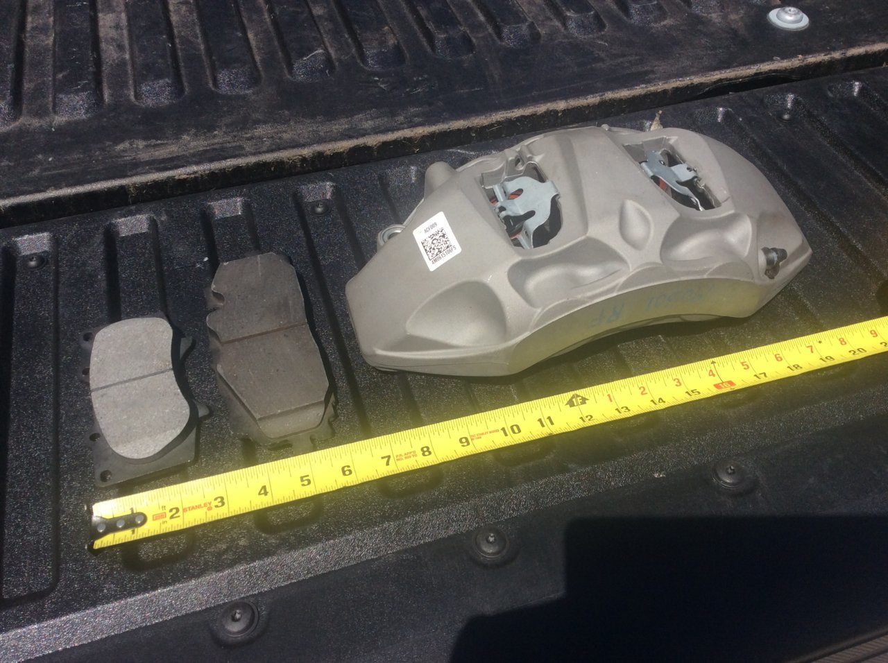

    Here's one of the calipers I am investigating for use with 17" wheels. It's a newer monoblock design by Akebono. It's from an OEM application and piston area is very close to the existing stock caliper. Like many recent modern calipers, it has a cast in center bridge for a great increase in stiffness. Pad changes are more involved, but that's non-issue here. Pads are large and of a funky asymmetrical design. Mount is radial. Pistons are 38/35/35.

    Silver powder coat.

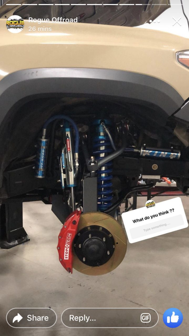

    That just looks like absurd amounts of dollars I'm not even sure where to start. Need wheels for scale!
    Norton likes this.
  20. Jul 3, 2019 at 11:25 PM
    #340
    MESO
    MESO Major Modder Vendor
    Feb 16, 2015
    #148809
    16,294
    State of Jefferson
    2016 DCLB TRD HELLCAT SWAP
    Looks great. What diameter rotors?
    Noticed you kept the sway, is that a TC part? I’ve only found it for their +2 kits.
