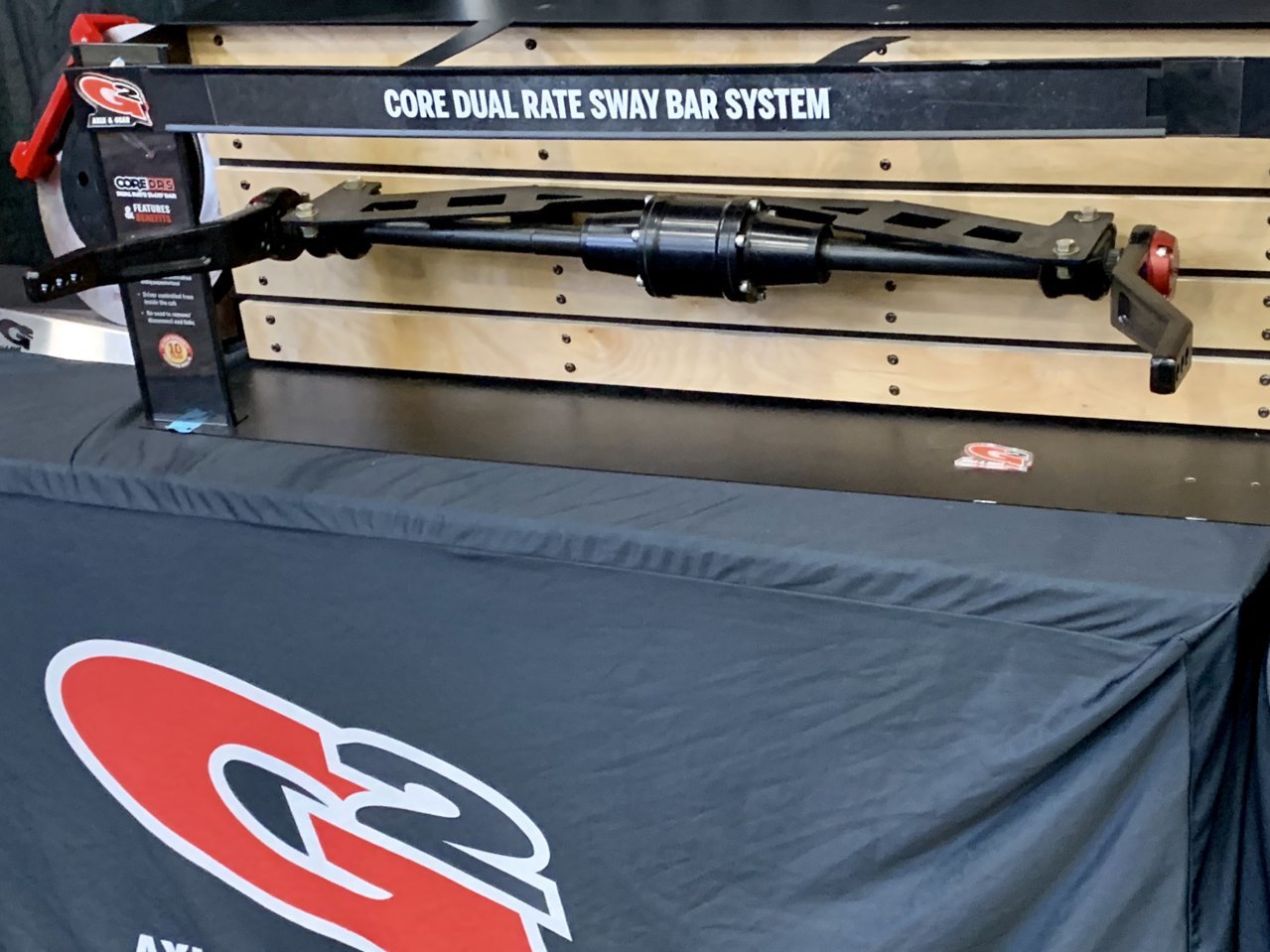

    I gotcha, I missed it was an aftermarket bar.
    Here is an example of a dual rate bar replacement I’d like to get in the Tacoma.

    Gotcha. Yeah that Looks nice but wouldn’t work with the tc long travel I don’t think.

    LT'd truck with swaybar...
