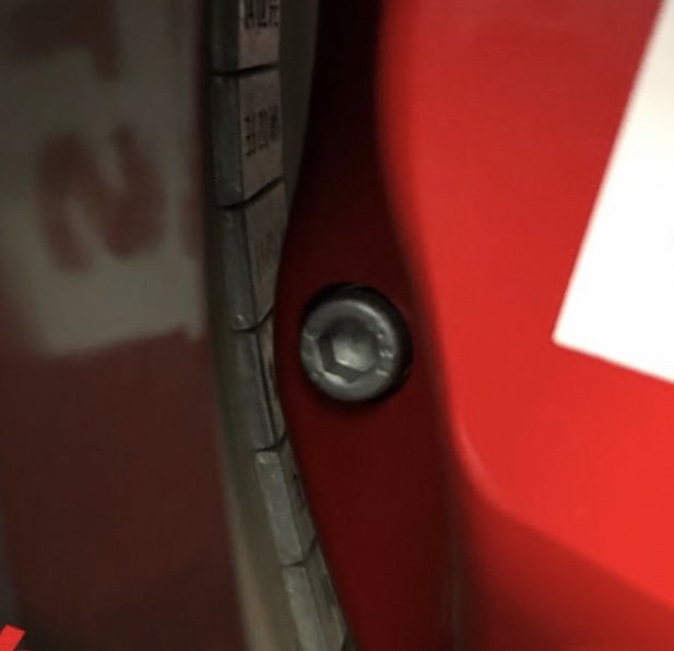

    The space between the caliber and wheel is letteraly 2-3mm space left. So with heat I’m guessing the metal can expend a bit on top of that so even at desert small rocks will get jammed likely. Also under heavy braking there is a small chance the caliper might move. Wheel weights is a problem, wrong placement and you will jamb it. Lastly I felt that a bit more room would let it cool down and breath more. I guess it was way too close for comfort sadly /: I was very bummed to let go of my volks

    Just some food for thought. I seriously doubt the calipers will expand enough or move enough since the spindles are forged so not likely to hit the wheels also lot's of high end sport cars have been running these set ups for ages with zero issues with aluminum calipers with a ton more heat... Also the smaller the gap the smaller the rock ever had a 1/2" rock wedge itself inside the disk and wheel? I would much rather have a 2mm piece of granite stuck in the disk than a 1/2" chunk which would be capable of grinding out the inside of the wheel until it becomes two pieces. Last but not least Dakar Rally trucks run these types of set-ups with zero problems. Any way 17's also have a ton of tire options as well so I understand that as well so I can see where you are coming from. But will I probably stay with my 16"s either way and I am sure we will both be happy! :cheers: & thanks again for letting us know about these brakes !!!

    A very good point about the rock size and space didn’t really think of it that way. I do like the fact I have a lot more choice on 285/75/17 option tire wise for sure! If you stick with 16 just watch the wheel weights placement that’s the biggest challenge especially with tire shops not exactly know for taking their time. Also my 16 was 8 wide so the caliper does stick out on the inside of the wheel so again if and when you are in the situation where the wheels is stuck in mud snow sand etc it will make it easier for damage since it’s not protected by the wheel very well. I guess I wanted to have piece of mind so I made the change. Ironically I went with stoptech primarily because they were supposed to clear 16” wheel. Wilwood was a cheaper option with a bigger diameter rotor but required 17”. At this point I just hope that stoptech is just a better product hahaha

    Here is illustration of just how tight a 16 rim will be with thinnest wheel weights you can find. You might not even fit a quarter between that gap /:

    Does that even freely clear?!

    That’s what I mean it’s litteraly hairline so I had no choice but to play it safe.
