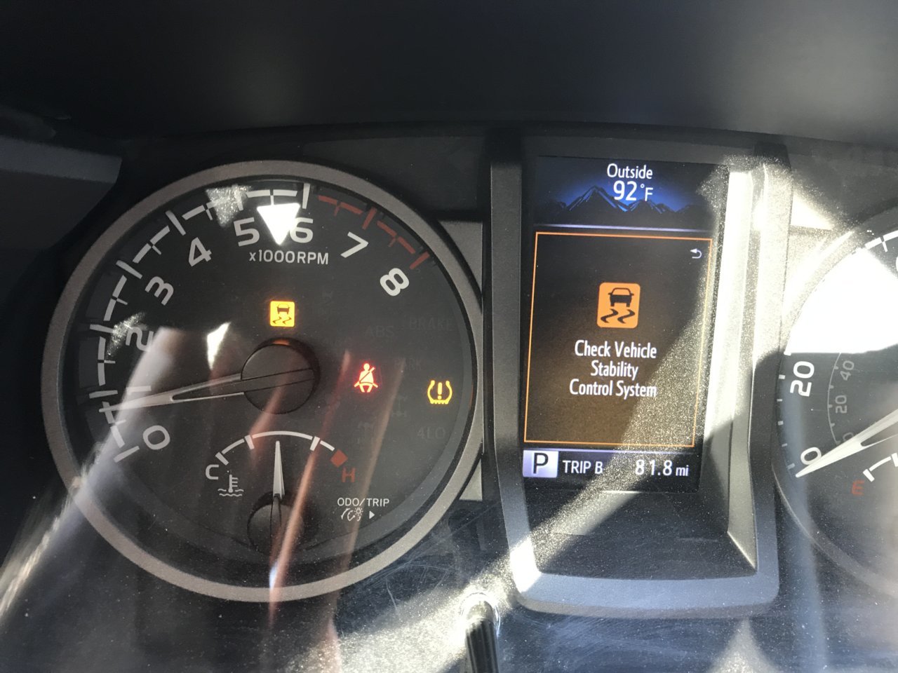

    Mine is 17 off road 4x4. The guy at the shop tested it out on his 17 off road 4x4 it’s the same truck. It works on his but not on mine. So we’re swaping master cylinder just for shits and giggles at this point to see if that will fix the issue on a hind side if I knew this going into it I would not have done it. Seems to me like very little gain for a lot of pain.

    The system is designed specifically for these trucks. StopTech is a major leading high quality USA brand, it isn’t like they would have botched this at the design level. Something isn’t right, especially being it works on another identical truck. Curious to see what you find out and hopefully it is sooner than later.

    So shop said they replaced the master cylinder brakes work /:braking power is marginally better in my opinion. Knowing it I wouldn’t have gone this route. Sad to say. New issue now while on the road to co stability control warning came on maybe 300 into the trip. Mild off roads maybe for 30 on gravel tripped it a few times and now it’s lit. Also tested crawl control functions getting system not available message. Any clues what this maybe related to and fix ? Don’t have my obd2 not sure what the hell is wrong.

    Man that brake job sounds like a can of worms.
    This might help your error:
    https://www.tacomaworld.com/threads/vsc-issue-after-lift.432245/

    Will probably sound dumb not sure what sst is. What tools regured to do this reset ? You are right the brake upgrade has been nothing but a waste of money and time. I presume the terrain system is part of the traction stability ? Maybe that’s why it doesn’t kick on.

    Did you upgrade the master cylinder?

    Maybe I don't know what I am talking about here but thought on the new gen that the crawl control and stability ties into the braking system and uses anti skid for controlling these. My guess is the may have not connected something or try replaced something with an after market part that just pissed of off the truck. Just saying, no expertise here.
