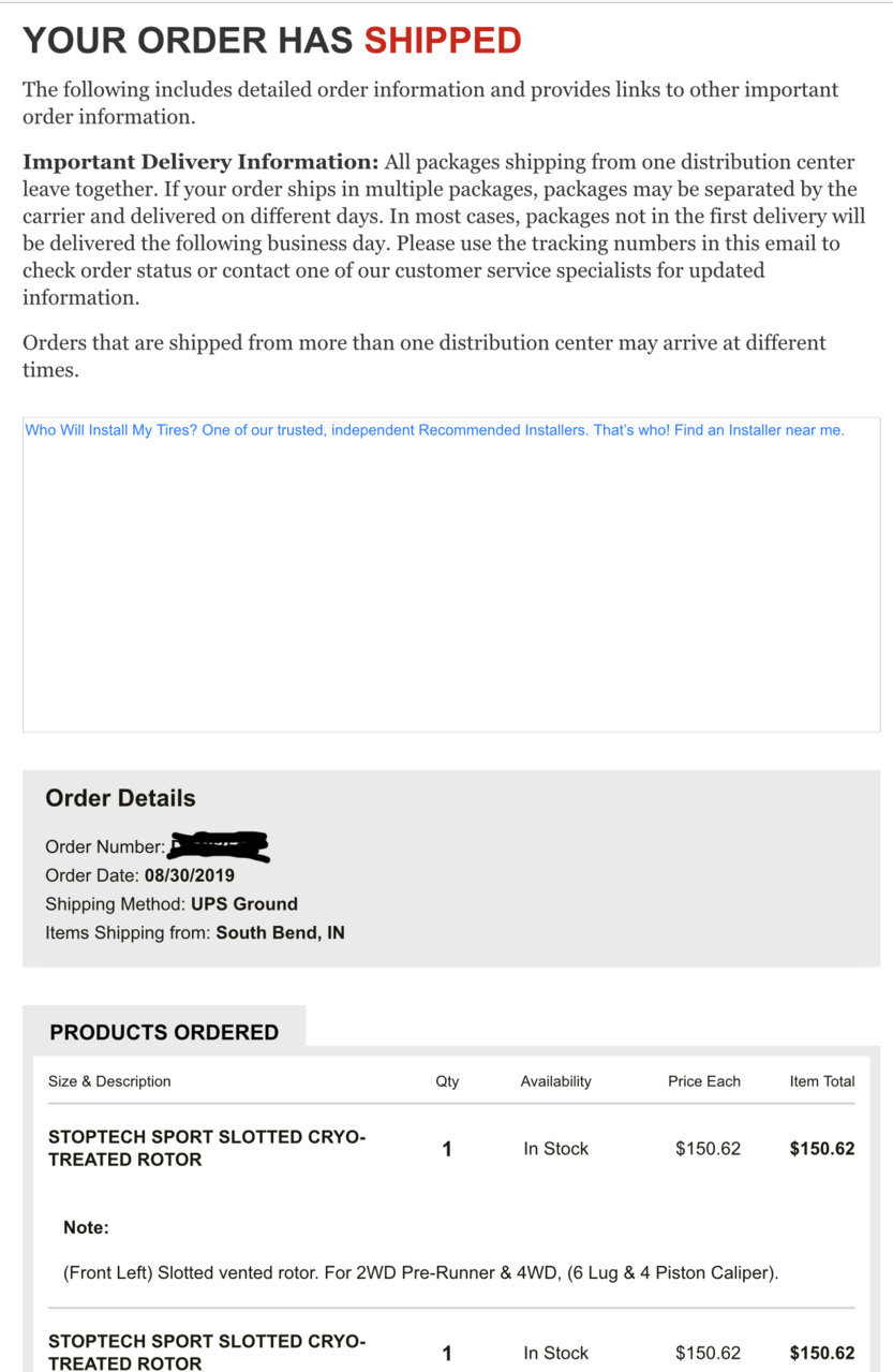

    Just ordered the StopTech Cryo’s from
    TireRack. This will be paired with the TRD Pads and refurbished Toyota OEM Calipers.

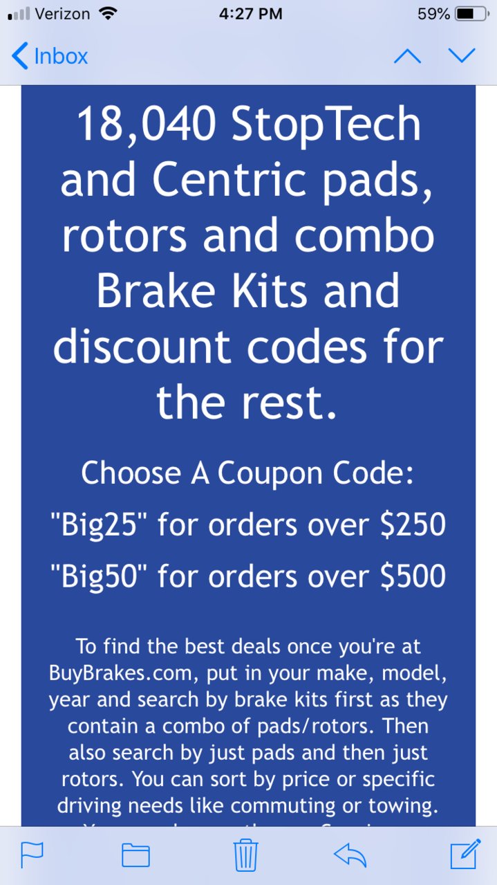

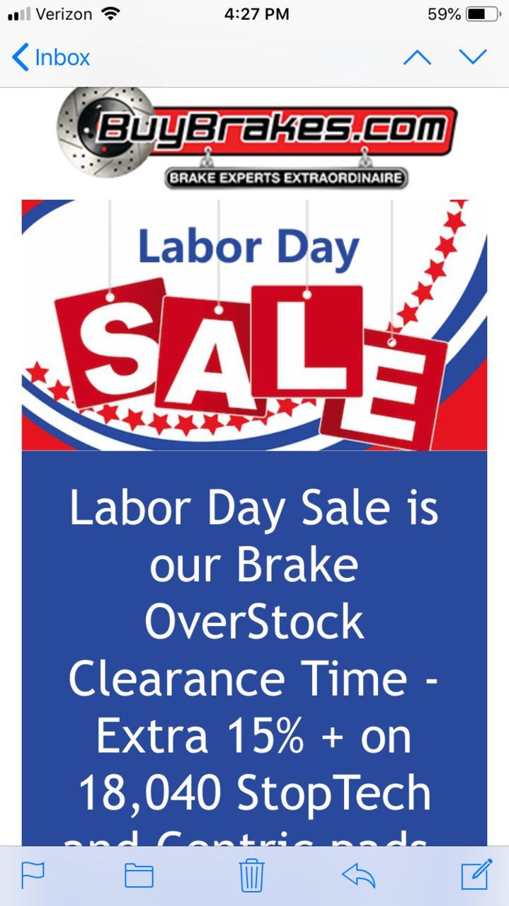

    Labor Day sale at buybrakes.com

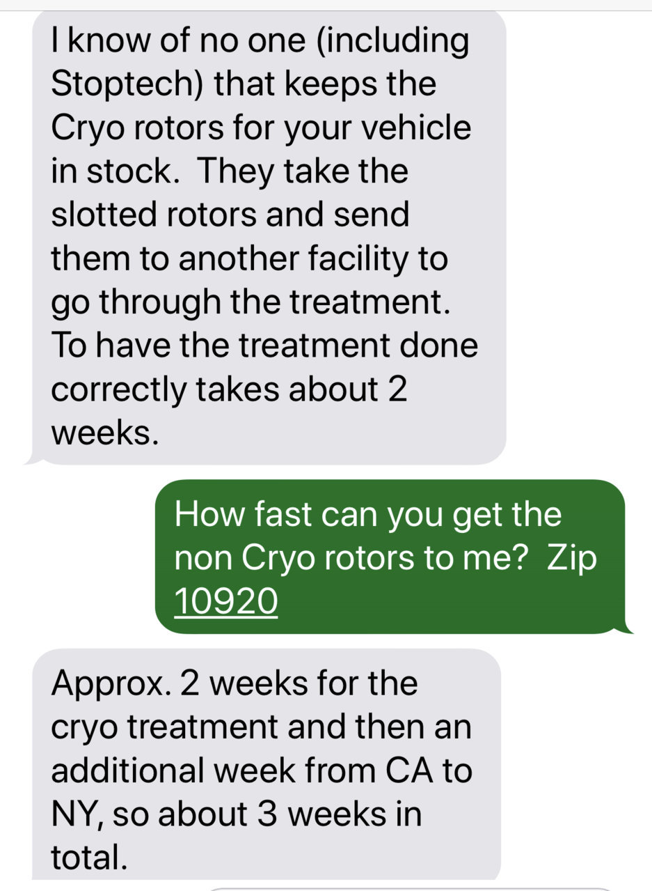

    I tried to order the StopTech Cryo Rotors from
    BuyBrakes today. They said three week ship time because it’s not available anywhere off the shelf because they do the special “Cryo “ treatment at the factory per order.
    I called BS and ordered from TireRack.
    They shipped within an hour of my order today.
    Lord Helmet and crashnburn80[OP] like this.

    Yep, definitely BS. Gotta love places with rapid shipping and good service.

    I would be surprised if they weren’t drop shipped from Compton, CA. They Cyro treat them out here.
