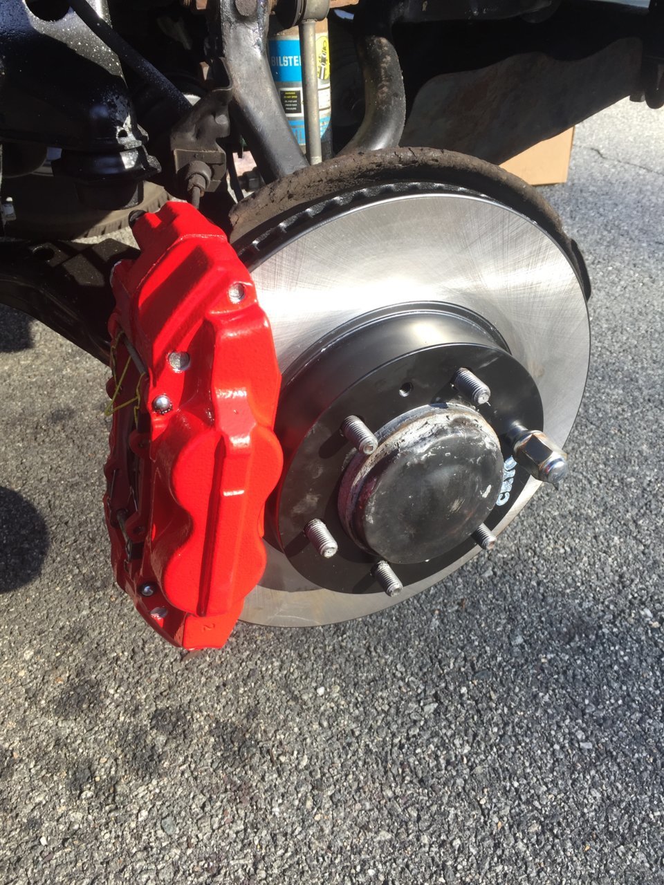

    Just wanna thank op for putting this thread together. Pulled the trigger on it, and some Napa calipers. 20% off anything at Napa all month if you’re a AAA member.
