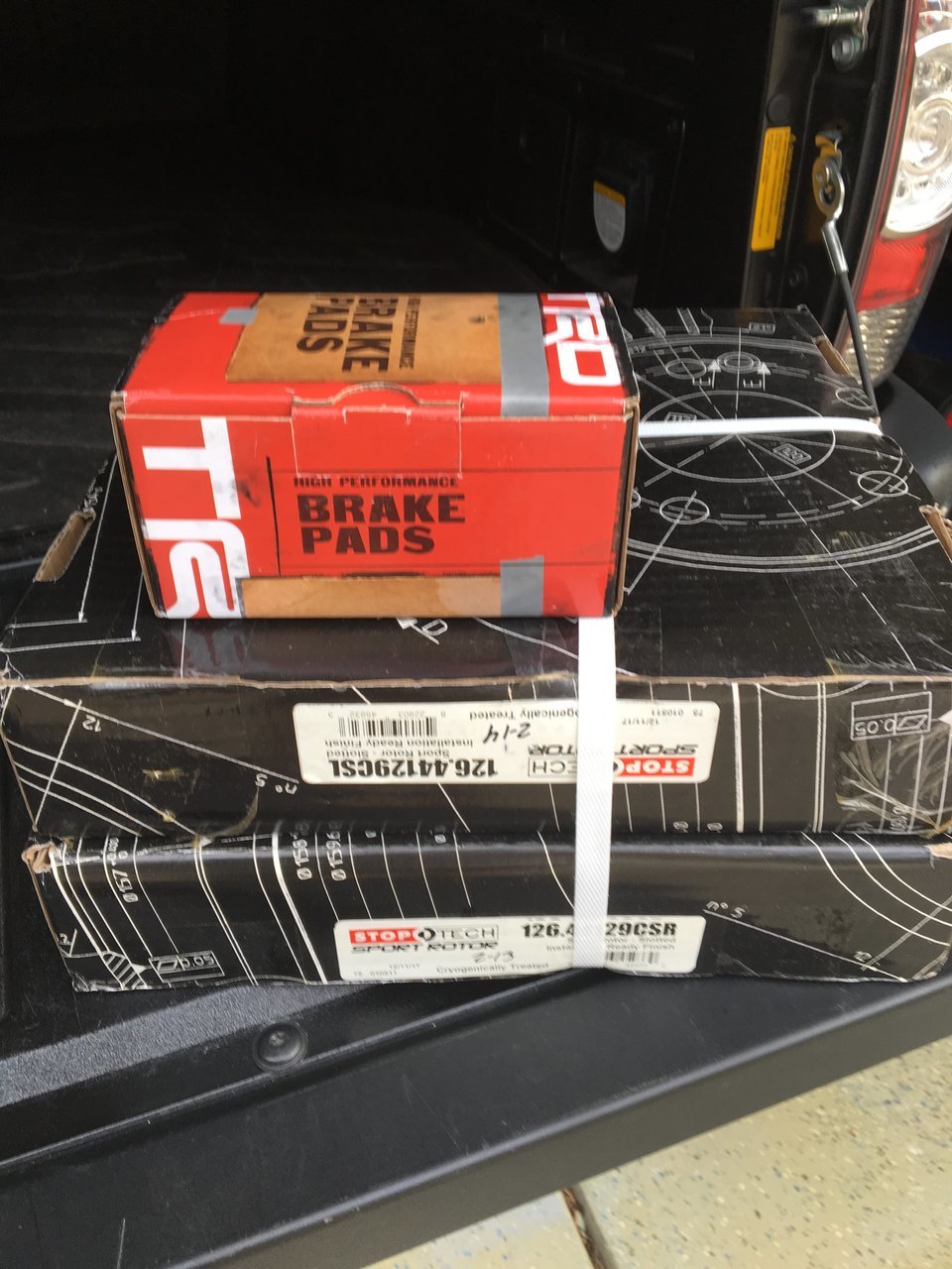

    Just ordered a set of TRD brake pads, going to replace my rotors in a couple of months. :D Can’t wait!

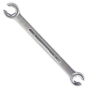

    The metal on the hard lines is stupid soft. Get some liquid wrench, and start soaking all connections a few days in advance. I just replaced all mine, and one of the hard lines rounded off. I just clamped it down like a mofo with some vice grips, and was able to break it free. Still working fine with no leaks, and now I can flex out without worry. I recommend @OCTaco for your brake lines. $119 shipped for all 4 corners, with a custom color and length.

    Also use a flare wrench on the hard lines. Helps to keep from rounding them off.

    Tonight’s project:
