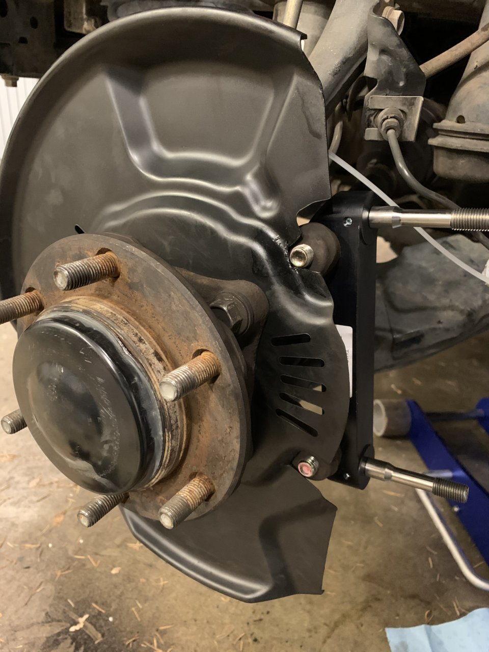

    StopTech 340mm ST60 6 piston BBK
    I am running 17" Rock Warrior wheels and want to stay at that size for best tire size selection in reasonable weight C-load tires while still giving good sidewall for off road use. The largest available rotor diameter available for a 17" wheel is the StopTech 340mm rotor, and the best caliper being the 6 piston ST-60. This is the largest diameter rotor and largest caliper available for a 17" wheel. Just like the original thread, I selected slotted rotors. The kit comes with rotors, calipers, caliper mounting brackets, braided lines and pads.
    The brake lines have an optional length when ordering, 0-2" lift or 3" lift. I have ~2.5" front lift so I selected the 3" line option. The lines are way too long and clearly for long travel. The picture below is at max drop and have have extra brake line for days. The kit came with StopTechs Street pads, which are their performance ceramic, but I may also swap them out for their Sport semi-metallic pads.

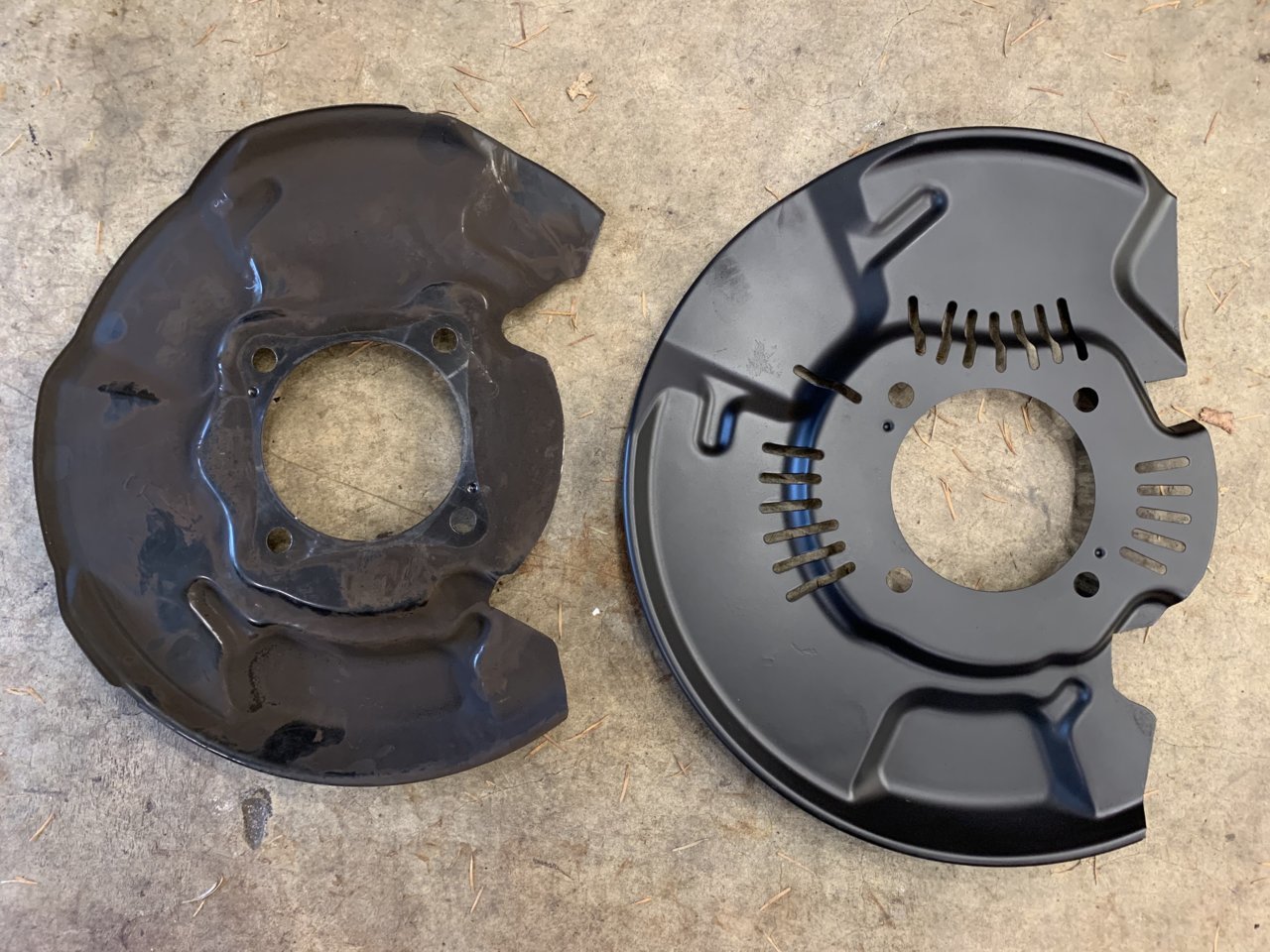

    The brake kit removes the dust shield and instead inserts a steel spacer in its place. I was not a fan of that idea, so I ordered the OEM 4runner dust shields for the 338mm rotors. Part numbers below.
    2010+ 4Runner dust shields for 338mm rotors

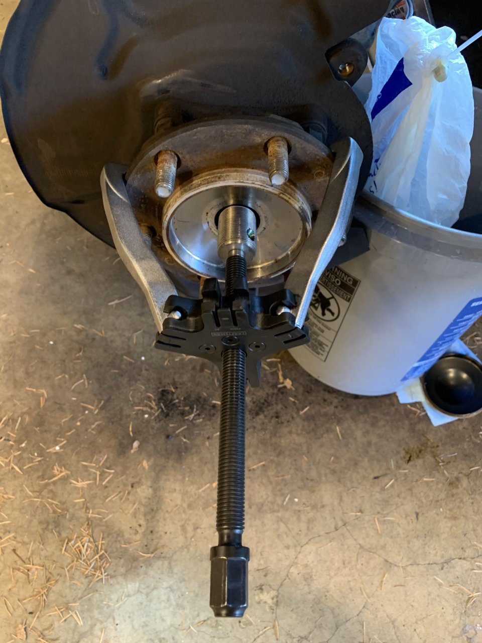

    To replace the dust shield or even install the spacer, you must pull the hub. This involves:
    1) Carefully removing the cover plate with a screwdriver and 5lb hammer
    2) Undoing the cotter pin
    3) Removing the 35mm bolt that is tightened to 173ft/lbs with an impact gun or pry bar while your assistant holds the hub from rotating. Requires a 35mm socket!
    4) Unbolting hub from flange using crescent wrenches behind the rotating assembly
    5) Breaking the hub free from the CV splines (shown below, puller not required)
    6) Pulling the hub assembly off to remove the dust shield
    While the 4runner shields are large enough for the massive rotors, they will not fit the over sized calipers. The shield must be cut and repainted to fit the oversized StopTech calipers. The 4runner shield does have vents, unlike the Tacoma version.
    Stock Tacoma vs cut 2010+ 4runner
    The StopTech kit used longer bolts to mount the caliper bracket, which interfered with the dust shield. So after having everything installed, I had to remove it all to clearance the dust shield for the caliper bracket mounting bolts. Shown with the caliper mounting bracket bolted into place.

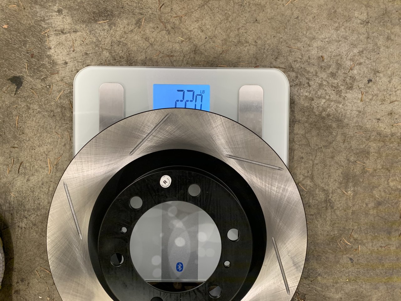

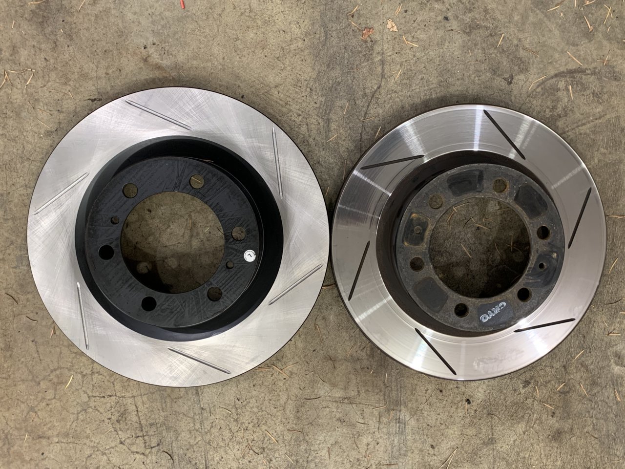

    StopTech 340mm rotor vs stock size 319mm
    Stock rotors weigh 17.8lbs, StopTech stock size 19.4lbs, StopTech 340mm BBk 22.0lbs. 24% more than stock.
