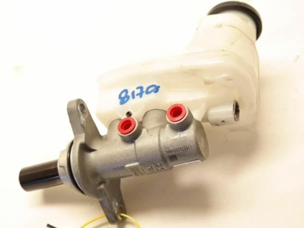

    Also, for non Atrac, the 2018+ Camry has what looks like, at this point, a bolt in master cylinder that won't require an adapter or line extensions.

    Is the Camry master much larger? The Sequoia upgrade kit doesn’t cost much and is for a larger heavier truck vs a lighter Camry.

    The Camry unit is either 23 ( same as 1st. Gen Sequoia) or 23.8mm (same as 2nd Gen Tundra), I have yet to verify.... that will happen this week. It looks nearly identical to the Tacoma unit, and should only require having the fluid reservoir swapped.

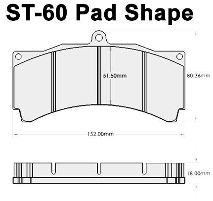

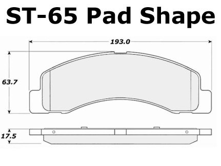

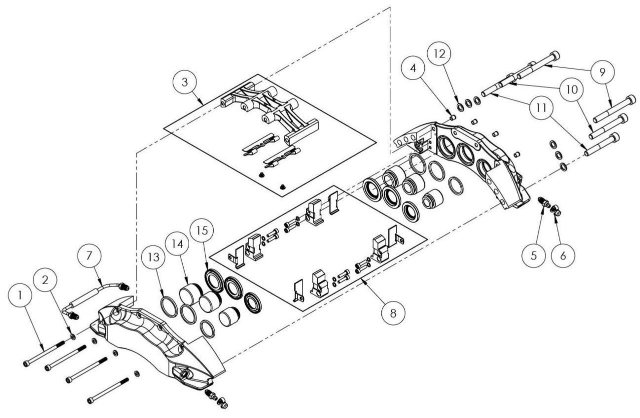

    Another interesting thing... the ST60 (which you have) and the ST65 Calipers appear to use the same body. Small spacers are bolted into the ST60 which allows it to use a smaller pad than the ST65. If the piston sizes can handle it, why not go for the larger pads of the ST65, too? Might be worth looking into?
    crashnburn80[OP] likes this.
  7. Dec 7, 2019 at 11:19 AM
    #627
    crashnburn80
    crashnburn80 [OP] Vehicle Design Engineer
    Jun 6, 2015
    #156893
    14,772
    Kirkland, WA
    2003 DCSB TRD OR

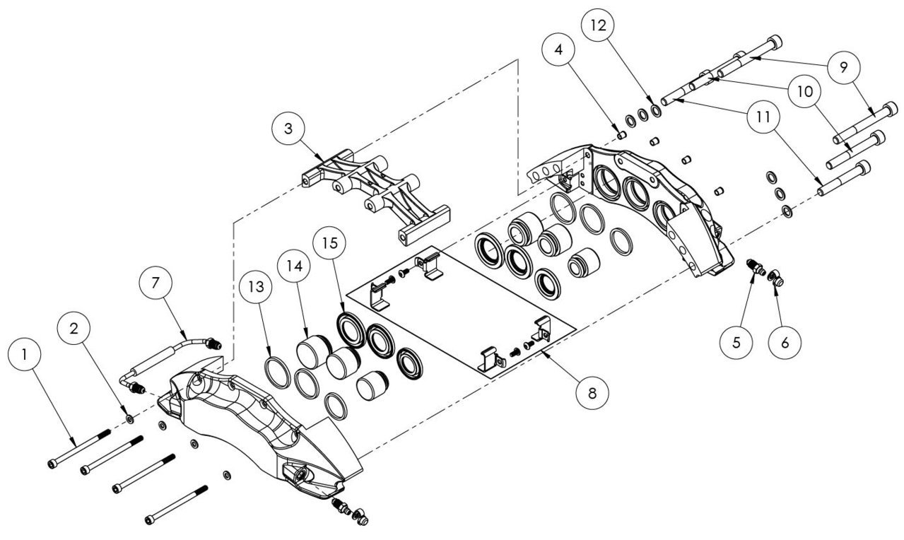

    Interesting. I don’t have a picture of the inside of the caliper. Do you have an image of the spacers you are referring to? The pads on the ST60 are already quite a bit larger than stock, how much larger are the ST65 pads?
  8. Dec 7, 2019 at 11:34 AM
    #628
    Jowett
    Jowett Well-Known Member
    May 5, 2016
    #186182
    1,635
    Brian
    North Adams, MA
    Here are the calipers and pads. Note part 8 on each caliper, those spacers hold the smaller pad on the ST60 1st pic.IMG_3131.jpgIMG_3132.jpgIMG_3129.jpgIMG_3130.jpg

    Interesting. Where’d you get the diagrams? Ever since StopTech was acquired by APC the APC website is much less useful with less technical information available than the old StopTech site.
  10. Dec 7, 2019 at 1:20 PM
    #630
    Jowett
    May 5, 2016
    #186182
    1,635
    Brian
    North Adams, MA
    Agree with you on that! The new web page is much less useful. These came from a google image search... dealers with replacement parts and info are starting to become much more accommodating.
