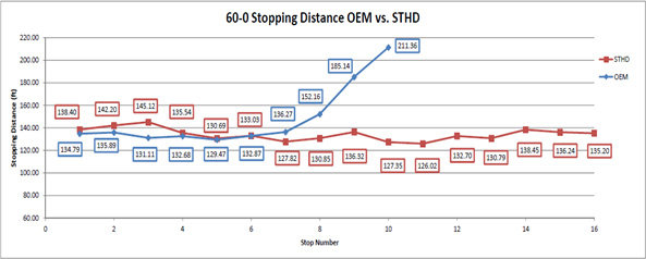

    Here is a great write up, with data!, showing how Stoptech's big brakes for armored Toyota Land Cruisers perform on the job. I find it interesting that the rear discs are the source/starting point for the fade. Throws some cold water on the Tacoma rear drum brakes are up to the task debate.
    http://acearmour.com/armoured-brake-kits/

    Very interesting. Though not really an apples to apples to apples comparison, as the armored LC used in those tests is rear weight biased, being heavier in the rear than front. Where as the Tacoma has almost no weight in the rear. I like the testing though, it would be interesting to see something similar on a pickup.
